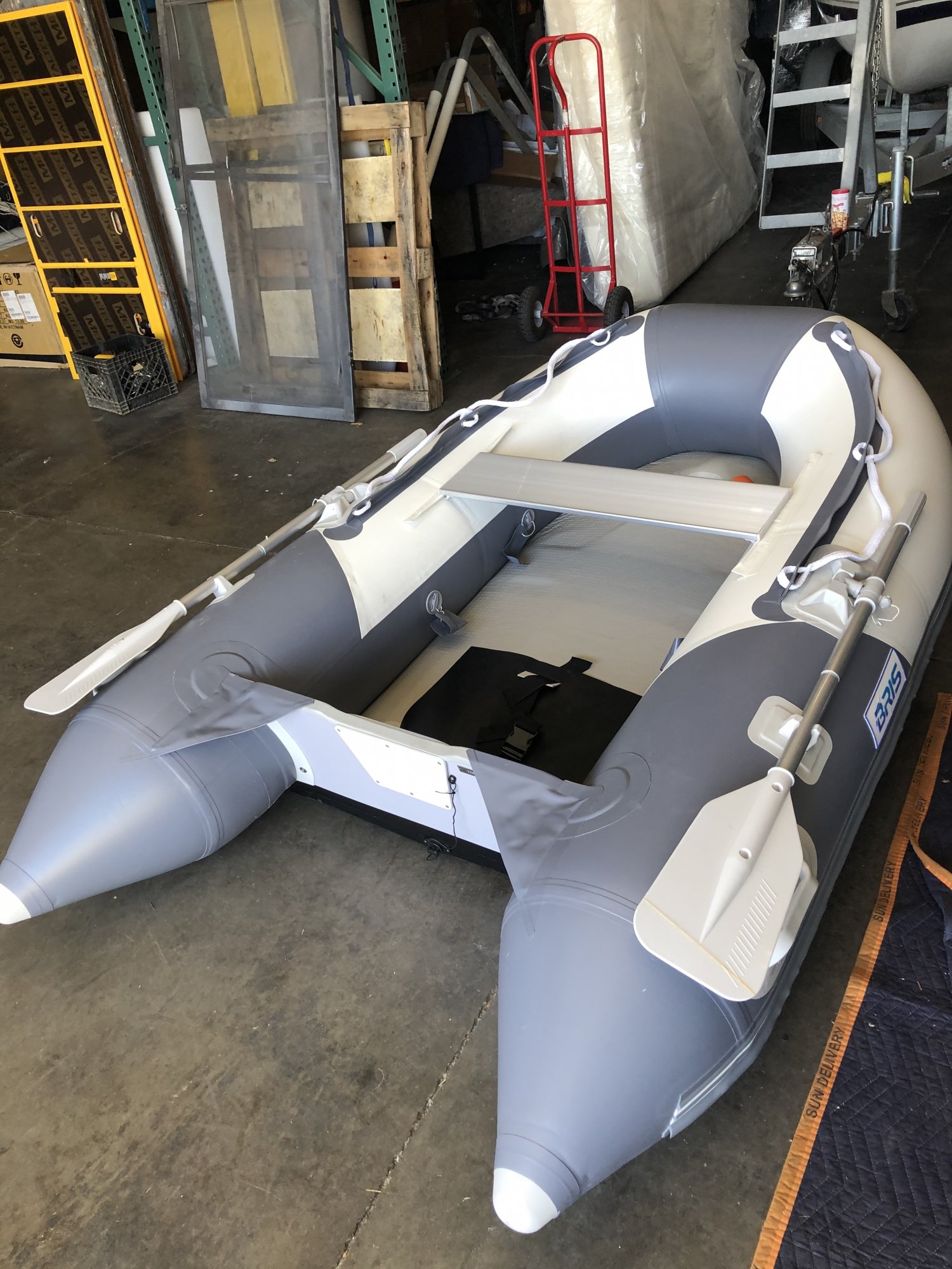

I had our H23 on a mooring on a lake a few seasons. I started using a "toy" inflatable as a dingy but it was difficult to step out of it to the boat,even using our swim platform. You may find boarding from a kayak to be tricky. I ended up building a wood insert floor for the raft, which was workable.

Yes. Getting on the boat from both kayak and inflatable dinghy was always tricky. Got wet a couple of times....
