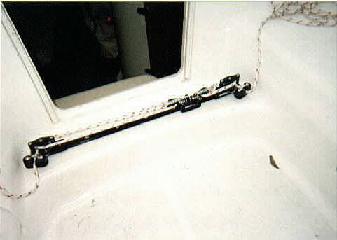

The previous owner of my H26 put a small (short) traveler on the lower surface of the companionway. It has some use for sail control, but also gets the mainsheet tackle out of the cockpit. BrianW

The mainsheet attaches to a "U" bolt in the center of the cockpit this can be inconvienent if you have a wheel. Some have placed a traveler at the base of the cabin hatch but I don't like that solution because then it is in the way.
Here's Richard's solution in the knowledgebase: http://sbo.sailboatowners.com/index.php?option=com_mtree&task=viewlink&link_id=6797&Itemid=257

On my previous boat I moved the mainsheet attachment point forward to the bridge deck and installed a traveller. I was concerned it would be in the way all the time. We found that was not the case at all and liked it much better. I have thought about doing the same thing with the H260. However I like to use a boom tent at anchor and so the mainsheet would not be able to be moved to one side with a traveller in order to clear access to the companionway. I could move it back to the u-bolt when using the boom tent I guess.
I think if you move the lower anchor point on a mainsheet you need to consider how the forces will change on the boom, the attachment point on the boom may also need to be moved. If the boom was designed to be sheeted near the end and you move the sheet a lot closer to the mast the forces will increase significantly. The angle the mainsheet makes with the boom must also be considered.
