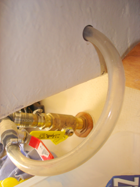

I added a cooler drain on my boat, a short hose from the cooler drain through a ball valve to a T installed on the drain for the sink, makes lfe much easier on a longer cruise. (I added extra hose clamps and insulation to the hose since the picture was taken.)
