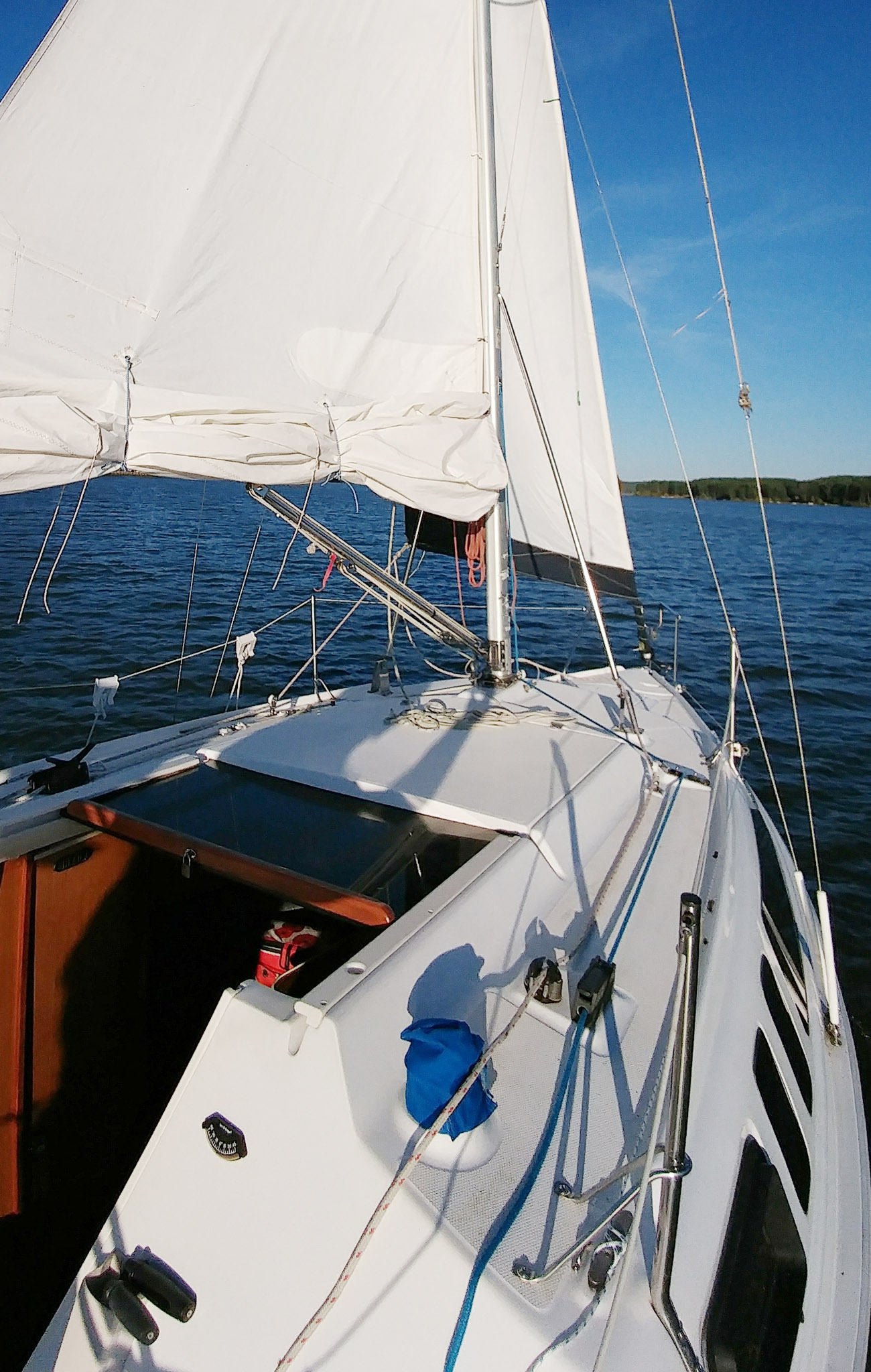

I sail my boat solo often in 25kts. The standard setup for the jib sheets is not correct . I added a fairlead to the forward cleats. Wrap the winch and lock out the forward cleat . Cleat after the winch which is not then loaded as the load is wrapped around the winch.
Next time sailing , try just tying a piece of rope thru the cleat to lock them open . Next add extra wraps to the winch and sail . This way you will not have the jib sheets jammed under load .

On my H26, I installed cam cleats on the vertical surface behind the winch. it works well.

I am by no means an expert but from the picture it almost looks like the starboard cam cleat is installed backwards? The jaws should open to aft not forward. If that is the case it will pop out for sure.
You still have the covers on the winch which tells me you are not using the winch to carry some of the load on the jib sheets. I always lock the sheet in the cam and then put a couple of wraps around the winch.

can you supply a photo or two what you are talking about. Sometimes I may have missed something which many of us do. I wouold appreciate it. Thank you sir and also for your contributions to the forum.
