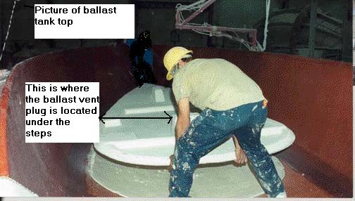

Water ballast vent stopper not sealing or not inserted.
Seal around ballast fill valve rod - is wing nut securely tightened?

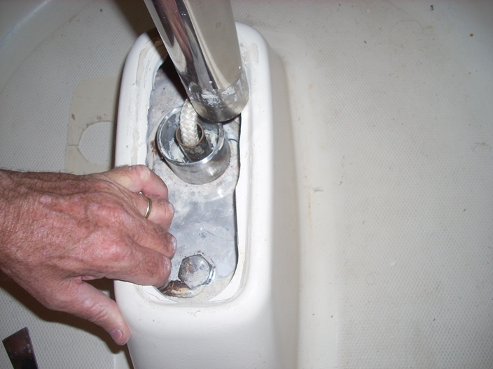

It is a fairly common occurrence for water leaks around the bolt and at the base of the compression pole. In some cases the bolt has corroded which prevents the bolt from being fully tightened or sealing properly. Do not remove the bolt while in the water as the bracket and centreboard can be lost to the depths. In some cases there are screw holes into the compression pole through the bracket that need additional sealant as well.

Second under the bottom step going into the cabin you will see a wing nut; is it closed? To the port side of the wing nut is a vent for air to be vented when filling the tank; is it closed off with drain bail plug?

At the base of the compression post is a two part beige cover plate held in place with silicon. Cut the silicon and remove the plate. You will see a large bolt. Where the ss compression post sits there should be a #10 bolt in the receiver of the compression post and one on the backside as well
advise if two #10 bolts are in. Make sure that the bolt is tight using a 1 1/8 inch Is there any caulk around the bolt.

At the base of the compression post, we see the bolt and it is very tight. However, how do you see the backside to locate the other bolt? Also, we did check this area before and the visible top part of this area has remained dry. Could there possibly be a crack in the area where the centerboard pivots? Could the pivot pin crack the hull?

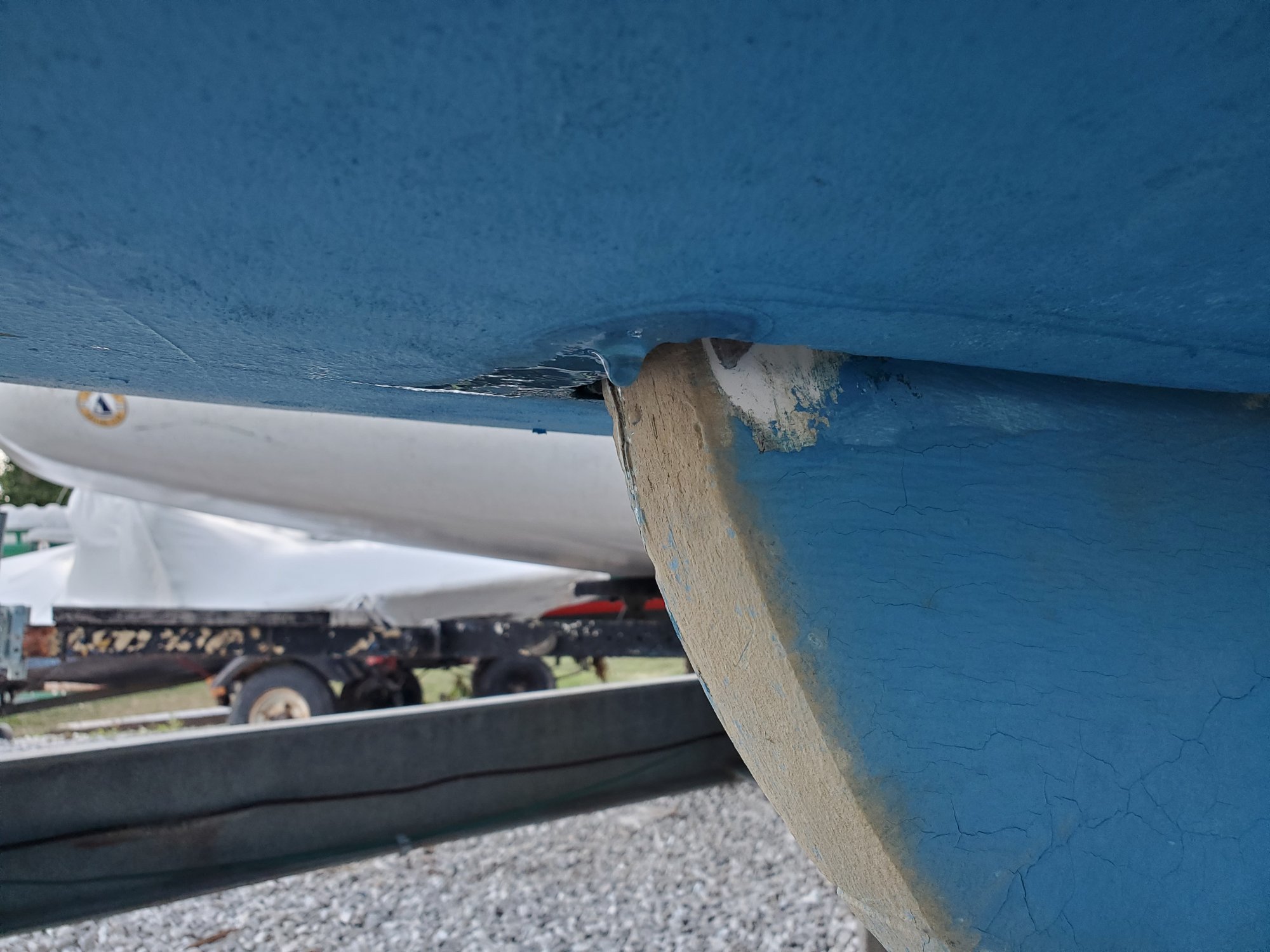

Crazy Dave and all -- Our Hunter 26 has been out of the water now for a week sitting on the trailer. Last Sunday, we put the boat in the water to see if we could find any leaks on the inside. Saw nothing. However, right below the centerboard pin on the bottom of the hull, there is a small crack where water has been dripping every day for the past 7 days. About 8 to 10 seconds between drips. I raised the bow with the trailer winch about 8" causing it to tilt toward the stern. The water that was dripping stopped as the water in the boat was displaced toward the stern, however, no water has showed up around the bilge pump as before, so there must not be much water left.
After seeing pictures of the ballast being installed, I cannot tell if the water coming in from the crack in the hull then travels under the ballast, or, in addition, we have a leak in the ballast. How does the water distribute once inside the boat to other areas, such as the side lockers and the bilge area? If the crack in the hull is the only entry point, I have seasoned "glass" guys at the sailing club that will patch the affected area. Here is a picture of the drip location:

In order to find the leak you will likely need to recreate the conditions in which you found the water coming in. Ie, get 6- adults to come aboard and see if you can see where the water is entering. Use flour, talc, Kleenex or paper towel to trace around the likely candidates for leaking - base of compression post, around the top of the ballast vent/nut area under the wooden step, around all thru hulls etc.
Have you had any rain in the last week? Water at the location you have indicated could be coming from a saturated centreboard, water accumulating in the compression post from the mast step area as well as from the ballast tank. You could place dye in the ballast tank and fill with water from a garden hose to see if it is the source of the drip.
If water as getting in from the top of the ballast tank you would likely be seeing large amounts of water entering pretty much all the time. If water is entering the hull below the ballast tank and the tank is still fully sealed on top it wouldn’t likely be detrimental unless it’s a very large leak which would allow the ballast to escape when the boat was healed.

Try adding some RIT dye to the ballast tank and then see if the color comes out that drip
