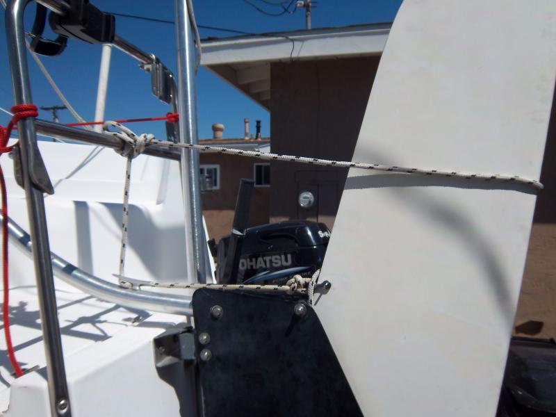

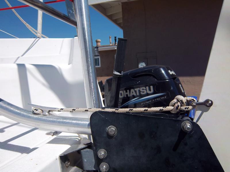

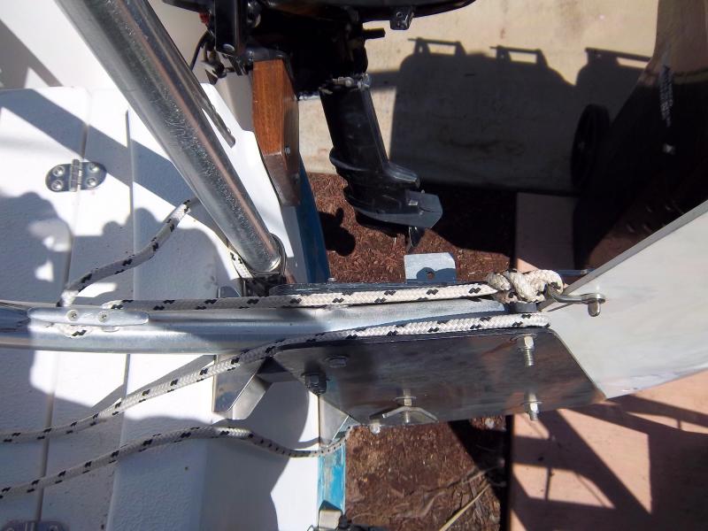

I drilled a half inch hole in the back of the rudder about two inches above the rudder bracket. Filled it with epoxy. Re drilled it with a quarter inch bit and put a long shackle in it. Then attached the uphaul line to the shackle. Now when I rise the rudder it comes all the way up with very little effort. I then use the left over line to wrap around the rudder to secure it to the boat while going down the road. I also moved the cleat from the bottom of the tiller to the top of the tiller where it is easer to access. I left the down haul where it was. This works great foe me.

Good idea for large hole filled with expoxy but eventually the shackle will rub thru the epoxy. You might want to put a tube in so the shackle will go thru that held in place by the epoxy which would prevent chafing by the shackle thru the epoxy.

Could you post a picture? I might try that. Thanks!

Here are some pictures of my rudder up-haul line. Also some of my downhaul line wrapped around the rudder.

That's what I was picturing. Thanks! Unfortunately I still have 4+ weeks of winter season before I can see my boat again. Thanks for the pictures. I'm sure this gives the original poster Dam Boat more to consider.
