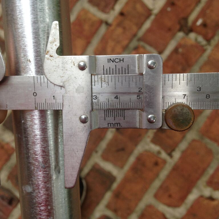

thanks rgranger for the work and the pics. I don't know that I've ever seen outdoor fencing poles in lowes but will look.

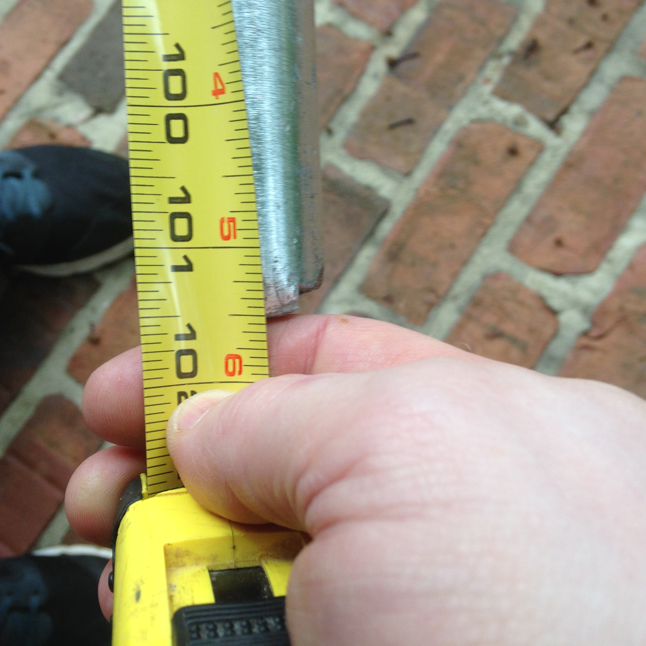

were you able to get one that is the 101 inches long though? I'm having a little trouble reading your calipers is that 1-1/4" in diameter ? also what is the thickness of the tubing wall on that fencing post.

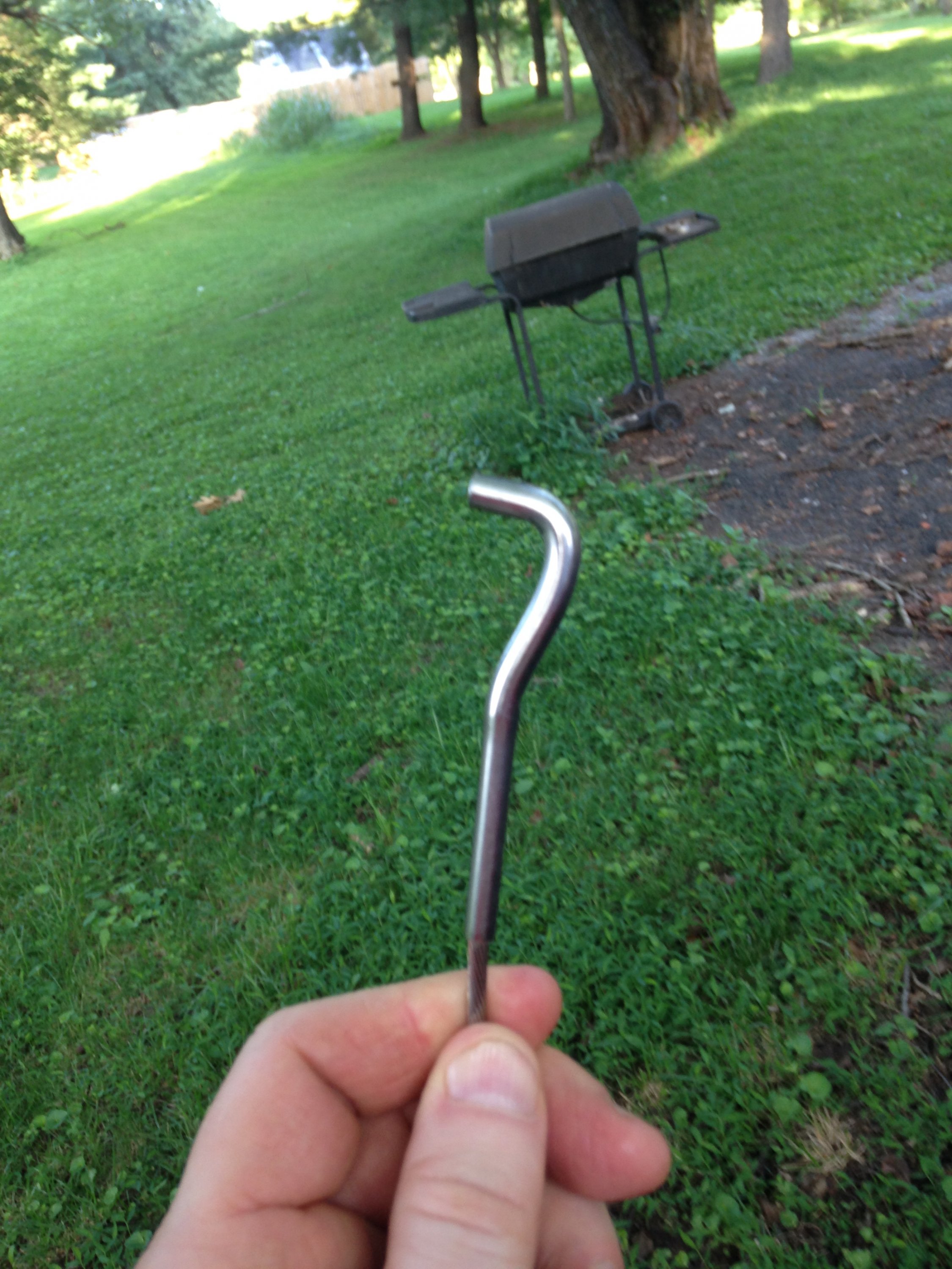

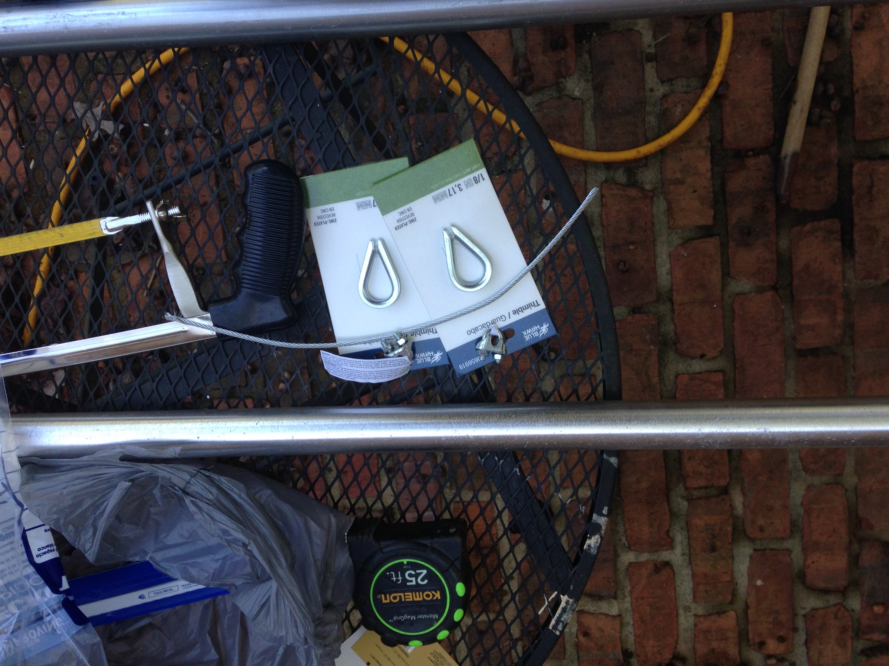

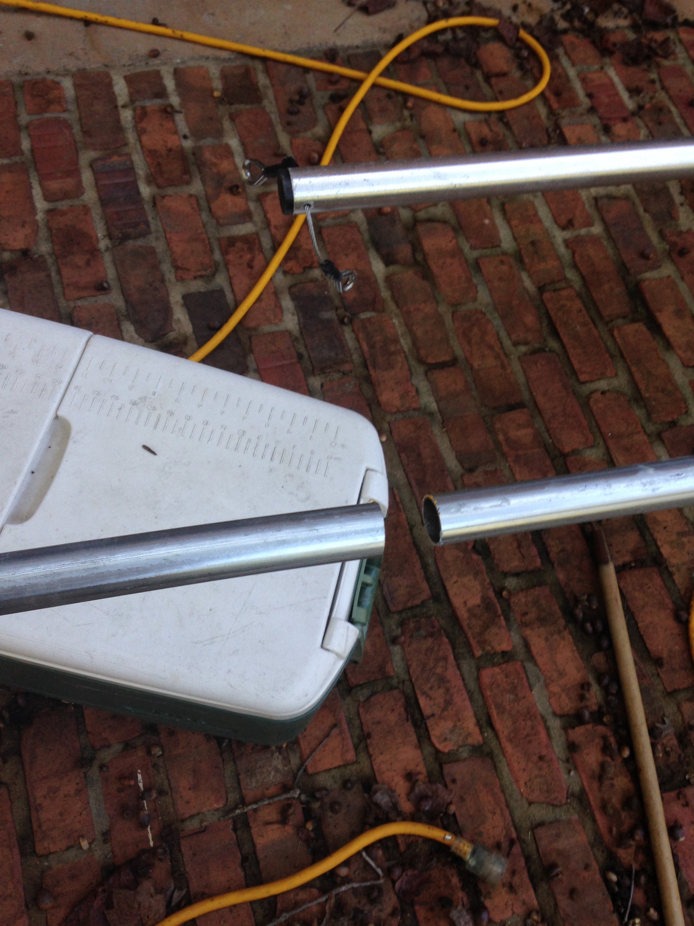

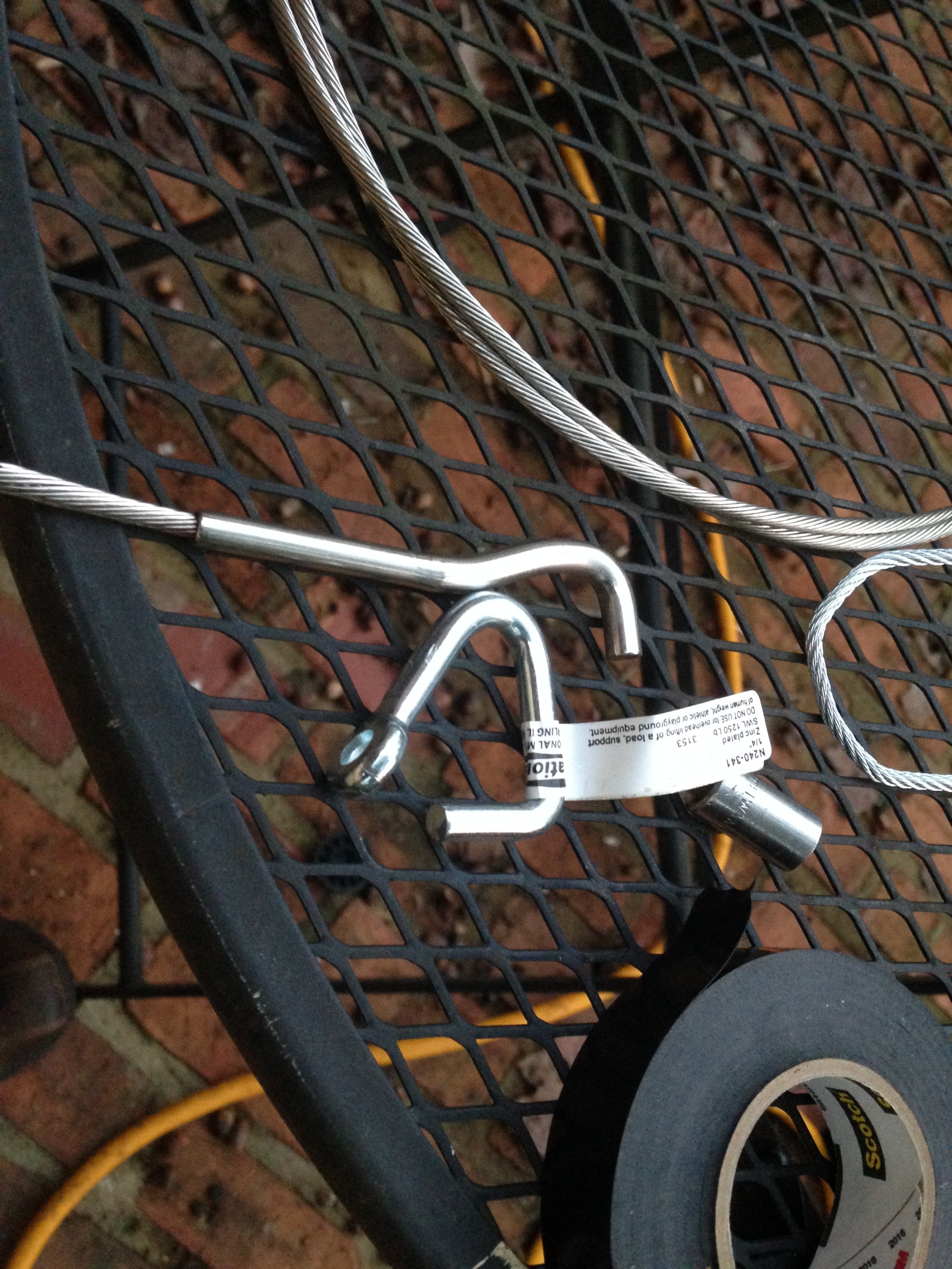

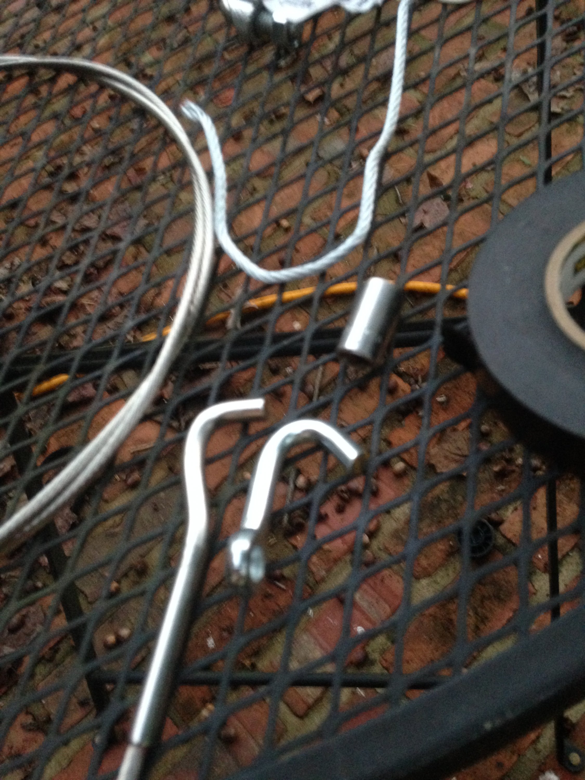

Hi @jbreland
I'm finally on my computer and should be able to give better posts now. If you go to the outdoor section and look in the chain-link fencing section, you will find the poles. I don't know the inner diameter only to say that the pole at Lowes was exactly the same as the pole used to make the gin pole. Yes I found them long enough (here are more pics)
I had to make a new pole because one of my baby stays pulled out during a rise and my mast fell. Did a lot of damage to the foot of the mast, bent the pole and bent the hooks for the baby stays.

Yep
It works fine. It is the same thickness as the original. Good luck!
