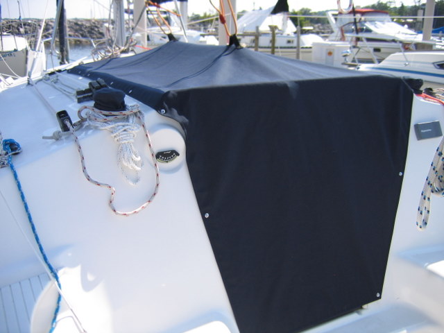

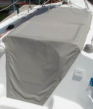

Our H-26 also leaked from the sliding cover ... what we did is purchase a custom made cover for the H-26 - with snaps, it completely covered the sliding hatch down to the cockpit floor. We purchased it here (Hunter Owner's.com) and was one of best investments we made.

As for your leak, I'd bet that a hatch/companionway canvas cover will solve the issue. Our '04 260 did the same thing and like the nut I am, I tried all the other remedies first. A few snaps and a piece of sunbrella material and life is perfectly dry again. It also shades the cabin nicely on those roasting summer days. Just do it.

The Sliding Hatch is probably the most common source of leaks. Virtually all H26/260s hatches leak to some degree or another. The H26 is notorious for a leaking hatch, but the later model H260's are more dry. Water can be forced into the cabin when washing the deck or during a driving rain. There is a teak strip in the forward portion of the sliding hatch that acts as a stop and diverts water to the slides. Make sure the wood strip covers the width of the hatch and that it is well caulked. As noted, the most success fixing this problem is by installing a sunbrella cover over the hatch.
Add a couple of loops to "tent" the cover so water runs off. I got that idea from Jim Seaman, an early and innovative H260 owner.
