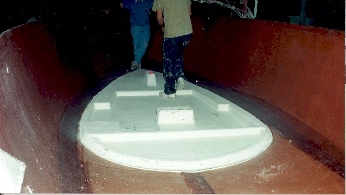

The sole of your boat is the top of the ballast tank. Don’t drill any holes! As mentioned in the previous response first priority is keeping water from getting in. In addition to the companionway you may also get some water at the compression post.
Here’s what it looks like during construction.
Raised portion behind foot is the step/ballast vent/ballast valve tower at base of companionway.
