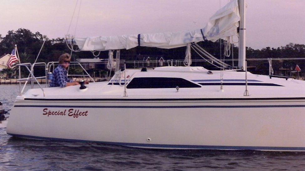

I'm glad you like the boat Jackdaw. I have one in my driveway I bought new in 1987, never got around to selling it. I moved it there in 2002, I keep a good cover on it and climb aboard every couple months to check on it.
I keep telling myself when I retire, I'm going to clean it up and use it in the Wednesday night lake races. A J105 owner that crews for me on my 340 sometimes, had one and likes to talk about it.
I did add six feet of genoa track to the side decks, but never got around to getting a headsail bigger than the 110 that came with it. It may not be a great racer, but it has more interior and deck room than most boats under 30', and it still is, IMO, one of the best looking boats Hunter made.
I would highly recommend it to anyone looking for a used boat in that size range.
