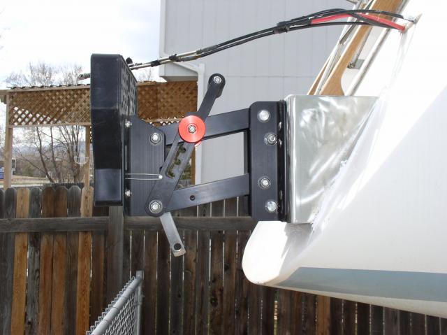

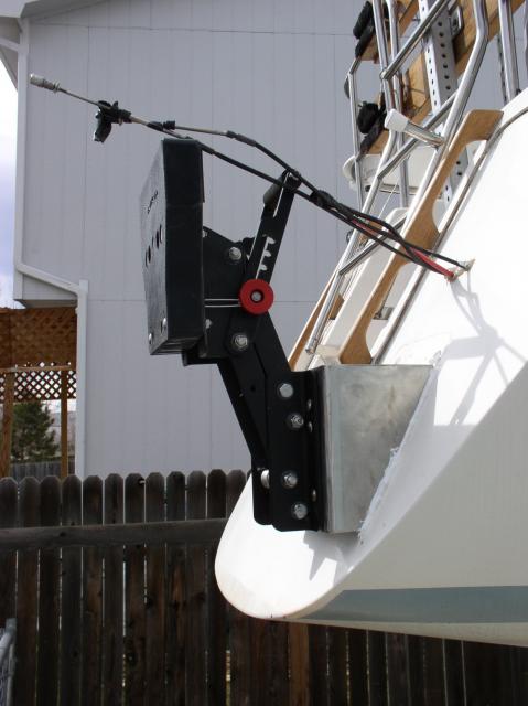

I ended up not liking the fact that I couldn't get the motor out of the water, so I designed a custom stainless wedge so that I could mount a Garelock (sp?) heavy duty 4-Stroke motor mount. Here are a couple of pics...

Did the same
I had a transom mounting bracket locally fabricated and attached the same lifting motor mount. It looks almost exactly like SV Walkabout's transom bracket. My Nissan 9.9 motor skeg, when lifted in the vertical position, is about 2 inches off the water. Really happy with the result.

I was just looking at the plans that I made up and unfortunately don't have any dimensions on them. I can go measure the one that I have in the next couple of days and get you that info. As far as fabricating another one, it would be cheaper for you to get one made locally.
I will however, take as many pics as you like and get the dimensions from the one I had built. I used 1/4" stainless steel plate that I had cut and then bent. The wedge is all one piece and then they just put it in a brake (metal bending machine) and then welded on two diagonal reinforcements at the upper corners. After that I just drilled the holes and mounted it. After mounting mine, I would recommend that you have the shop drill the holes in both the bracket and the backing plate. It is a real pain to drill stainless if you haven't worked with it much. I did install a 1/4" stainless steel backing plate as well that measured 14" x 14" inside the lazarette. The outboard bracket is a Garelock 4-stroke bracket that I highly recommend. The key to the whole thing is getting the wedge height set correctly above the waterline on the transom.
I bought the 9.9 Honda I am using on the used market and it has worked flawlessly. One word of caution though is that you will probably end up having to change the prop out as most motors come with a propellor for a planing hull. I went clear down to a 6.5 pitch 4 bladed prop (from an 8 pitch) and love it. Gets the boat up to hull speed, has plenty of torque, and the biggest benefit is that the reverse thrust available will let me do things that I really shouldn't.
The only thing that I would caution you on is pick your weather days when sailing with a transom hung outboard as breaking following waves could drown the motor hanging off the back. The prop also does come out of the water in anything over 2'-3' waves. Keep in mind that I am on an inland lake and that ocean waves should have a longer wave period. The little waves that I have to deal with are wind generated and very close together.
