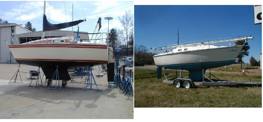

Here's a photo
Steve, I have an 86' 25.5 Fin Keel, and I love the boat. I have had other boats, but this is one of the best ever built in the 25 foot class. It has lots of wood inside, and a big boat feel, and easy to sail. I have lots of photos of 25.5's all over the country. Below is a photo of the shoal and fin keels.
