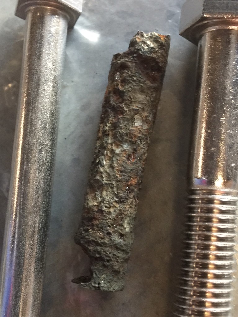

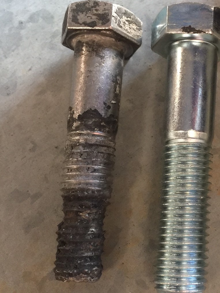

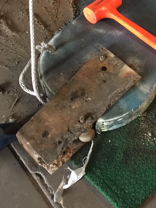

Here are photos of the keel bracket, the keel bracket bolt and one of the pins. I want to try a avoid this level of corrosion in the future. I believe that it is a 1998 H240.

Holy crap! I’m pretty sure we need a prize for best example of corrosion ever. We’ll call it the Arnie Award!

Thank you for the photos. The boat if memory serves me was first introduced at the Annapolis Boat Show in 1997 for the model year 1998 by me although dealers were receiving them a little earlier as the boat was being produced after August 1, 1997.
I note the corrosion but could not blow up the picture but either way it needs to be repaired or replaced. I am not familiar with the salinity levels of the Great Salt Lake, Utah if that is the culprit. What does concern me is the progression of the corrosion of the upper portion of the bracket being affected which is out of the water when bolted into place in the centerboard housing underneath the hull. Whatever you do I would still check for electrolysis at the marina as there are several sources that it could be coming from for example a faulty shore power chord in the water, faulty shore power on the dock and so on. It is also important to find that out so no one would be shocked if falling into the water around your boat. Therefore, at least throw over some sacrificial zincs and report back to us what is occurring if anything. I know you can use meters but the method I am not sure about. That would explain better the corrison on the upper part of the bracket that stays out of the water unless it is the salinity is the factor. Ask others around you at the marina as well for their thoughts. If the bracket is unrepairable, inquire with the forum store if they sell one to you. Simply go to the home page and click on store and at the top you will find contact information.

Thank you for your comprehensive reply. Thank you for your willingness to share your knowledge of these boats. We repaired the bracket and coated it with outboard motor paint to try to cut down the corrosion. We replaced with pins by cutting stainless bolts to size and replaced the keel bolt. The salinity level of the Great Salt Lake is about 11-12% and boats like mine remain in the lake year round since at that salinity level the lake does not freeze. Nor does the water in the ballast tanks. I intend to replace the bracket next time I pull out and in the meantime will through over some sacrificial zincs. I have not done this before. Do the zincs need to be attached to wires and grounded or can I just time them to some fishing leader and put them over the side.

In researching the corrosion issue, I think it is possible that the corrosion of the centerboard bracket and pins is not due to galvanic corrosion, but is stainless steel corrosion caused by long term exposure to an oxygen depleted moisture environment. The linked article refers to this as "crevice corrosion". http://www.bssa.org.uk/faq.php?id=9 I think my only remedy is to replace the bracket and pins, and I have ordered a set from SBO. Just in case, there is some galvanic corrosion taking place, I have also connected the centerboard bracket bolt to a guppy anode and placed the anode in the water near the centerboard. I will report what I find.
