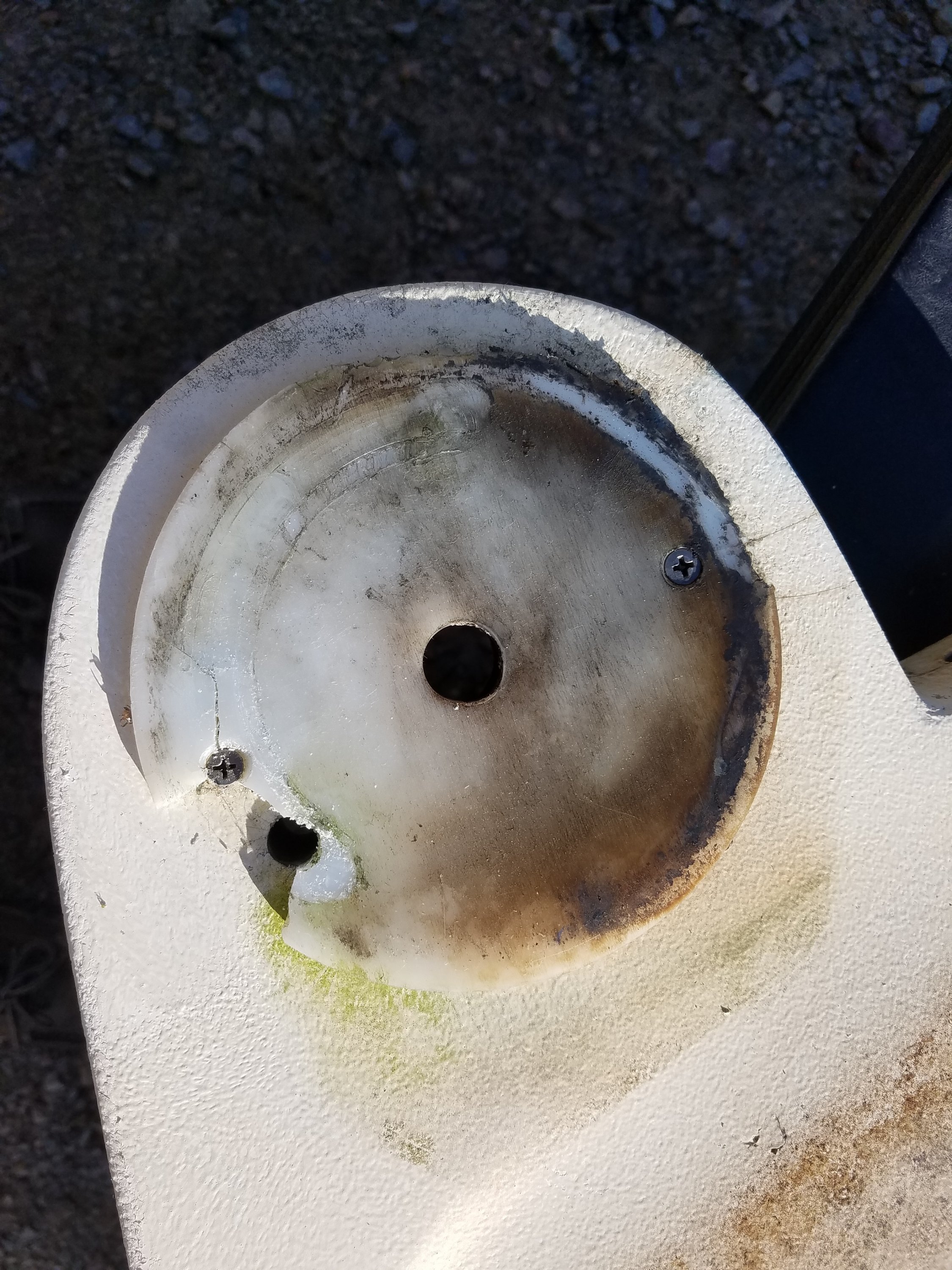

I dropped the centerboard and removed the rudder to do a little repair work to them.

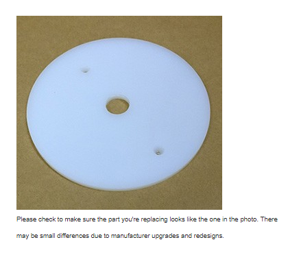

I know I need to replace these rudder parts and want to make sure I am ordering the correct part. Do you know if this is part # 800523 - RUDDER SPACER, SET OF TWO?

Yes, the photo shows the correct part for the 240. I replaced mine- they come undrilled for the screw holes (since every rudder is different), so save the old ones to use as a template to drill/countersink the new ones.
