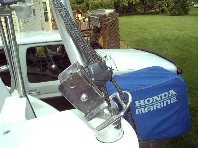

How about a spinlock?
Hayden, I was having the same problem until I removed the cleat and installed a spinlock 5/16", I think. It only takes a flick of the wrist to release the spinlock and the rudder comes right up. It also holds in down real tight. Jim S/V Java
