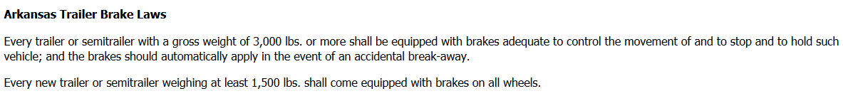

Is your trailer single axle or double? In Virginia (where I live) double axle trailers must have breaks. And they must be inspected each year. So there is a hassle factor to consider.
Here is what I found on Arkansas Trailer laws
