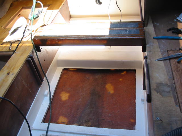

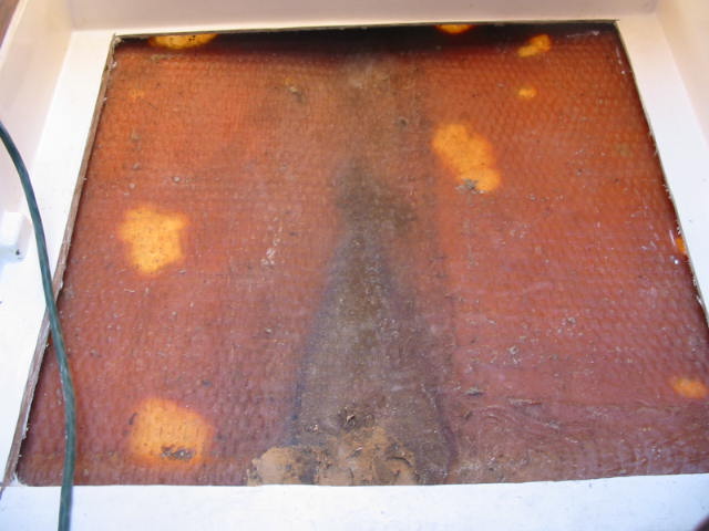

If you want to go back with glass, first consider where you would put supports and I suggest plastic strips/blocks or aluminum.
When replacing a deck on a Sunfish/Aquafinn, there are no access panels. What I do is cut the area out and then I would angle the cut from the inside to the outside minimum of 45 degrees but more is angle is better.
Then I would sand the underneath of the floor edges from 1-3 inches. I would then take a piece of cardboard with two strings that go thru the cardboard and back out which to hold with. Make sure the cardboard is 1-2 inches larger than hole in floor. Then put two layers of glass covering the cardboard with the strings coming up thru the glass. Make sure of course you can take the long lenght of the cardboard and insertinto the hole and then turning. With the cardboard laying down, I would then put resin on the glass and then brush on resin to the underneath edges of the floor board and then pull up and hold it in place unitl the resin starts to hold. What you are doing is putting a base of glass to the underneath making a false bottom. Let dry overnight and then ;you a good base which to lay a new floor.
Make sure the first layer of glass is as big as the hole and each additional overlaps a little to fill the flared edges. Obtain a resin roller from West Marine to smooth out wet glass and get the air bubbles out too. When you feel you have filled in, lket dry overnight. Then spray a little black or gray into the new glass and sand with a long board covered with sandpaper till smooth. Where paint is left will denote the valleys that have to still be filled.
