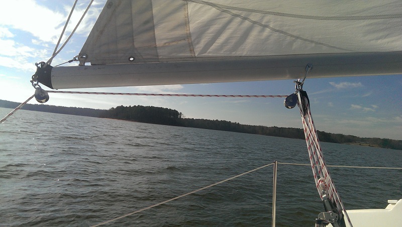

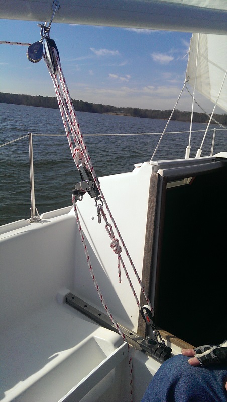

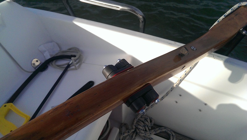

I've found the best way to rig things on my '23 is to clip a looped end of a medium diameter line (about 3/8") to the traveler/mainsheet block, then detach the block from the traveler car. With a pully attached to the traveler car, route the new line back to where the mainsheet attaches to the boom, to the end of the boom, down to a pulley on the leeward side of the boat, and finally to a cam-cleat on the tiller. This line is then counter-balanced by the elastics on the windward side of the tiller. Preferably, use 4-6 short lengths of surgical tubing. Attach/dettach tubing as needed to account for wind strength.
If you are curious I can take a picture of the setup when I'm at the boat this week. Its pretty slick when routed this way, mainly out of the way of crew, and finger-adjustable with the mainsheet vang.
