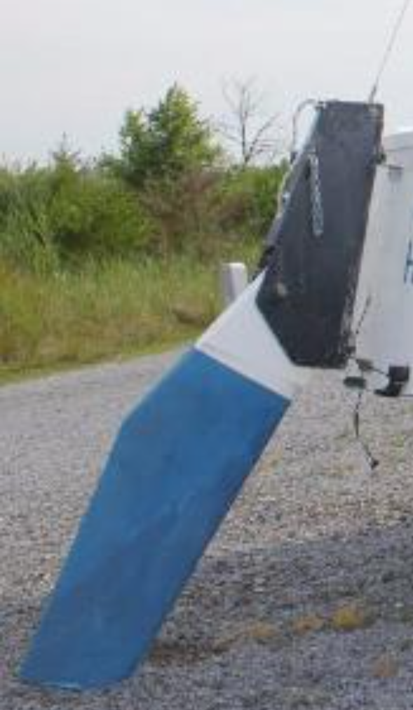

I always released the downhaul and gave the tiller a few shakes. Rudder pops up to Horizontal because it floats. My rudder head was snug enough that it wouldn't ever really go down past 45 degrees on gravity alone. Did Hunter eliminate the hinged rudder???

@Brian M H23
Thanks for the picture as I was going to ask for one.
You cannot have it fully down when loading up onto the trailer. Although the blade does float, you still need to steer with it. I suggest for safety tying up the blade so it doesn’t fall down and hit the ramp due to possible leaking if the seam is cracked
