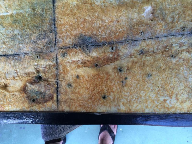

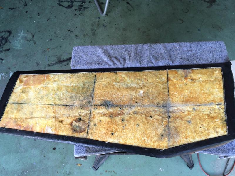

Looks like the gel coat/first layer of fiber glass is starting to separate from the core. I took it off the boat and washed it in prep for some new bottom paint. Left it in the good old FLA sun and noticed a bubble about the size of a softball, maybe larger bulging up on the starboard side. I have drilled a few holes in it to air it out and it is definitely wet under the skin. I am doing the alcohol drying treatment but don't think that's going to get it. Possible to pump it full of epoxy but I think it's weakened enough for a failure out on the high seas.
Any suggestions on repair, or what other have replaced theirs with. I see the Ida Sailor assemblies, but think I may have to move my pintles which I would like to try and avoid.
