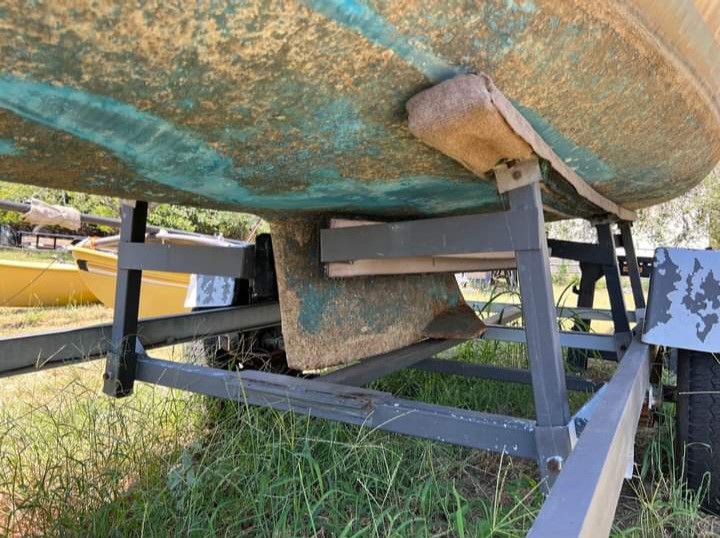

The keel had quite a bit of clumpy rust (knew that going in and am prepared to deal with, should I proceed with the purchase)
The bottom needs a good cleaning (also knew that going in). the "crud" on the bottom is just lake scum that dried. It flakes off really easily and will clean up nicely.
Cabin was in good to excellent shape, with dry bilges and no corrosion around keel bolts.

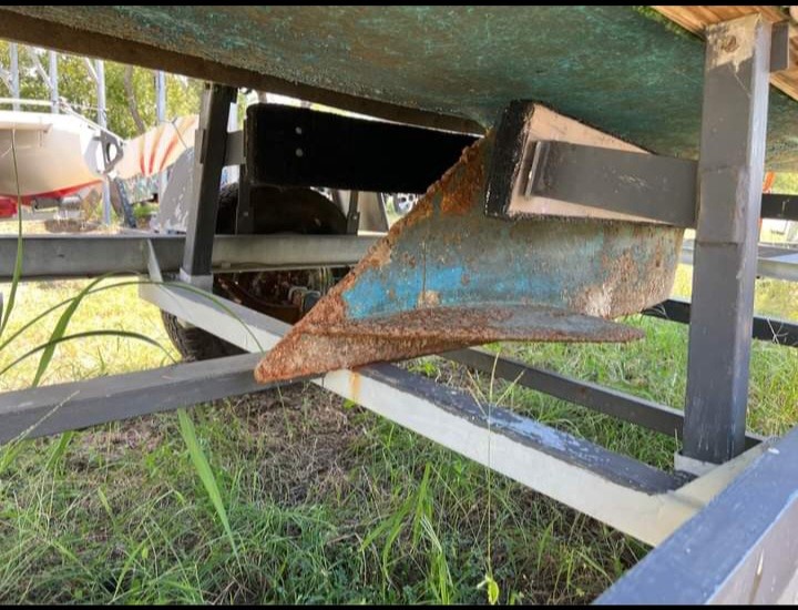

The aft end of the keel was resting on the metal part of the trailer
Now, from what I've read on this forum, the Hunter 23s should have about 70% of the weight of the boat should be on the keel, with the remaining 30% on the trailer bunks. I've also seen that there are usually wooden boards under the keel...this trailer did not have those.
From pictures I've seen, it looks like the forward, beefier end of the keel should be resting on those boards...in this case, it's the thinner, pointier end which is resting directly on one of the trailer cross-members (metal-on-metal), and not good for a 250 mile drive home.

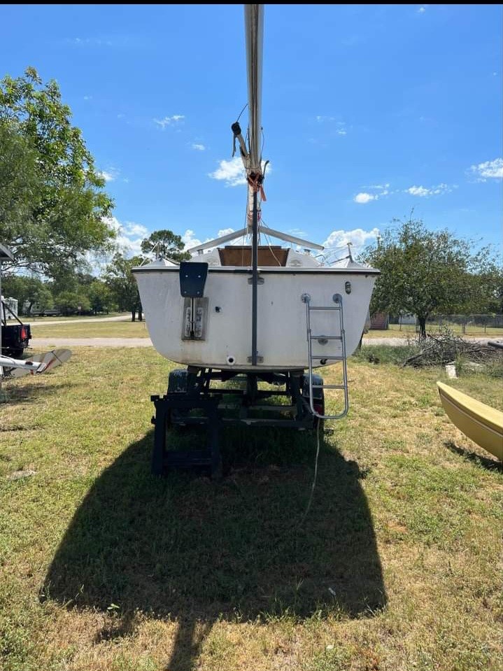

My other concern was that the keel almost seemed slightly bent to one side...ever so slightly to starboard.
Now, this could be an optical illusion from looking at the waterline and how it was sitting on the trailer (not perfectly centered, but you can almost make it out in the picture)
There were no cracks in the hull/keel bedding that I could see (which you would expect if the keel really had been bent).
This is the best picture I have of it...and it's kind of hard to tell from this picture.

I don't find my 23 overly tender. Of course, you need to watch things. I've had the gunwales a little in the water, but it didn't feel like it would go over much further. Hard to imagine the keel could have been bent, given there is no deformation of the fiberglass, and I assume you checked where you can see the keel bolts. As stated above, stepping the mast isn't a one person, 20 min job, so I would not want to be trailer sailing it. It can also be a bit challenging to get it positioned properly when pulling it back onto the trailer and you'll want a decently long ramp.

The owner of the boatf would not allow anyone to board. The bow was not all the way up to the bow chock missing it by three inches. Unknown about age of tires. Unknown as to age of bearings. No keel tray boards.
unless the owner corrected the above item, the boat is unsafe to tow. There is no known lift to pick up boat inn a small country town. The boat will shift easily when towing with keel sitting on bare metal. Trailer has surge brakes but unknown if working at all
I advised boat is unsafe to tow home 4 1/2 hour trip home

If you have fallen in love with this boat then there is nothing left to do but fix the problems … ask the owner to put it back in the water and then do the trailer mods to get the keel tray right … check the tires… repack the bearings … and make sure the breaks work. While in the water you can go on board and check out the lay of the cabin… and make sure the sails are not blown…
then get her right on the trailer…. And While the bottom is still moist stop at a self serve car wash and pressure wash the bottom and drive her home:beer:
