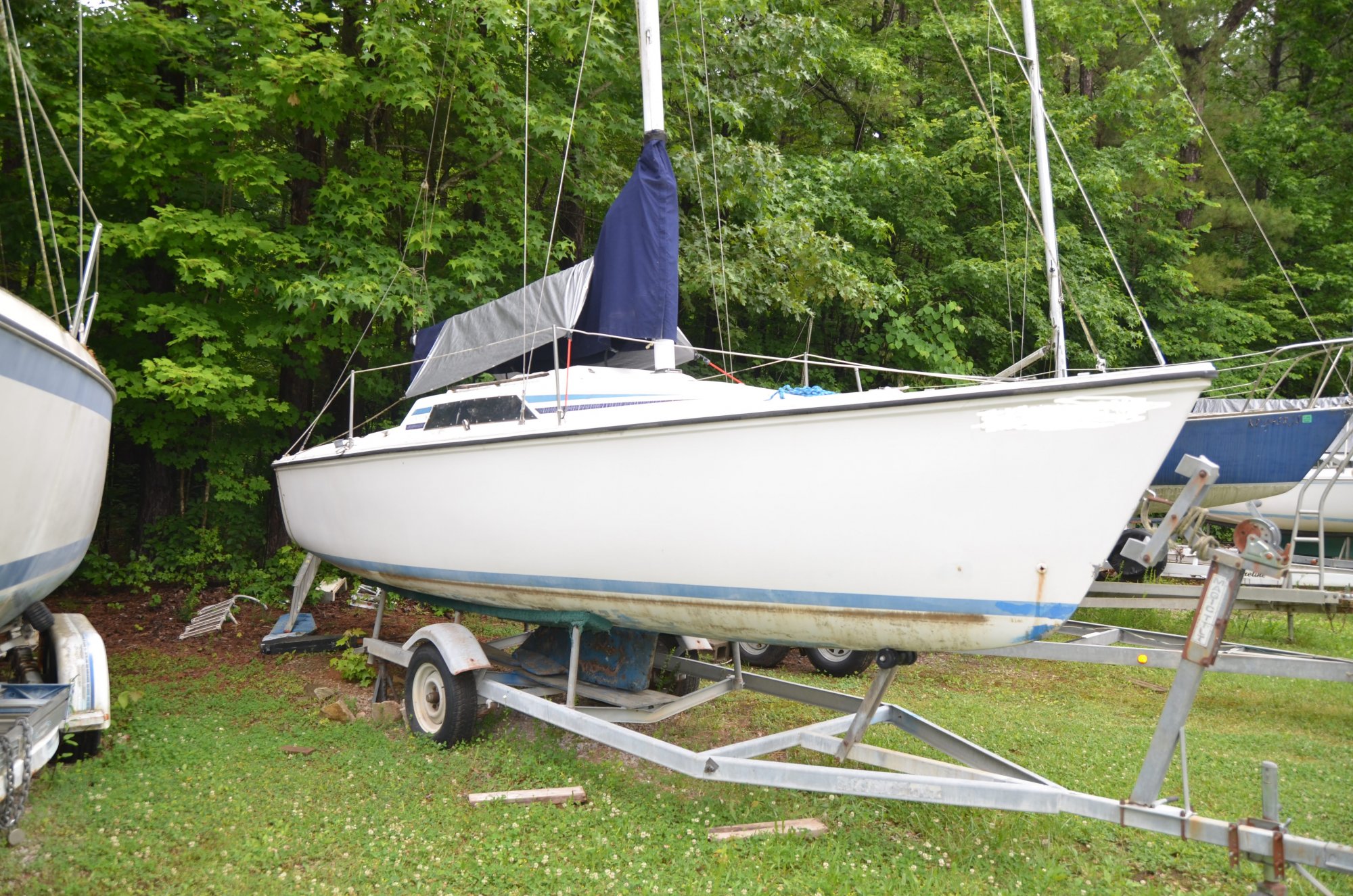

I'm a member of a small, "casual" sailboat club on an Army Corps lake in Kentucky. Last year I purchased a (basically) abandoned Hunter 23 from a former club member for $1200. Working sails, a trailer, Yamaha 6hp were included in the sale. It's been on the hard for years.
Unknown upper leak contributed to significant interior water damage. Initially we were hoping the leak was from the chain locker drain, or the hatch, or leaky deck fittings. Thinking- find the leak, epoxy/R&R some bulkheads and get on the water.

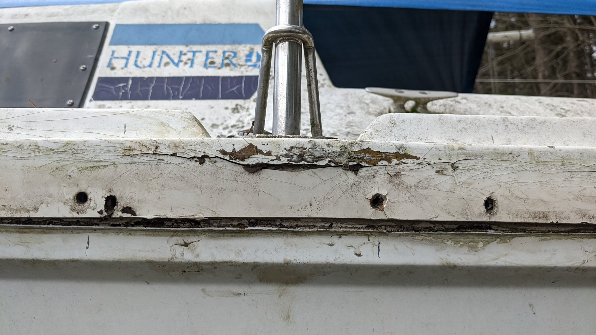

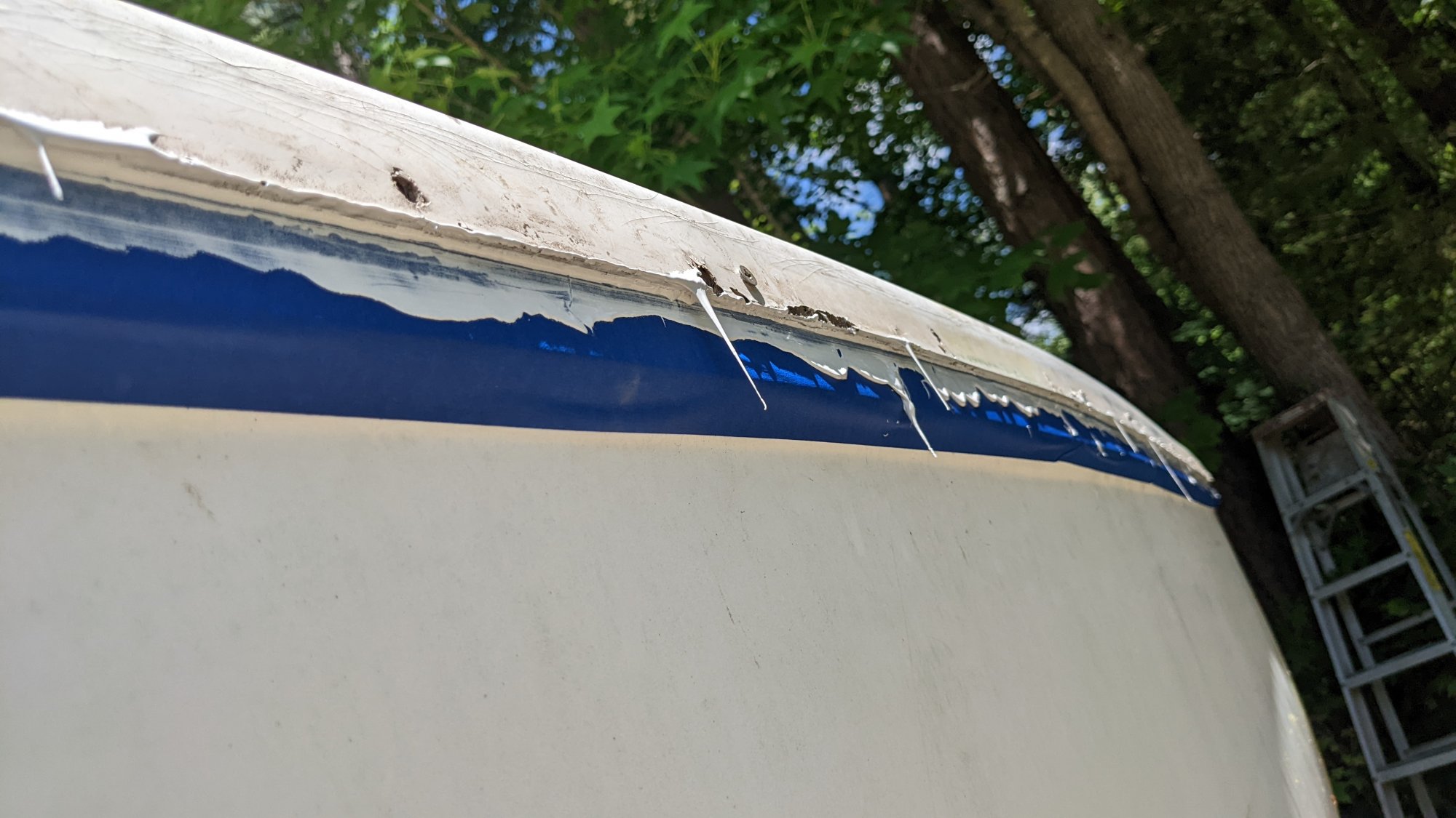

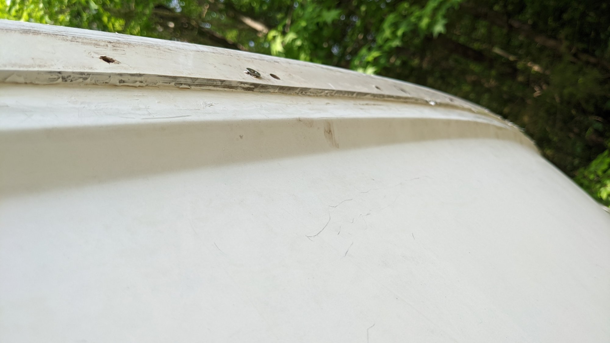

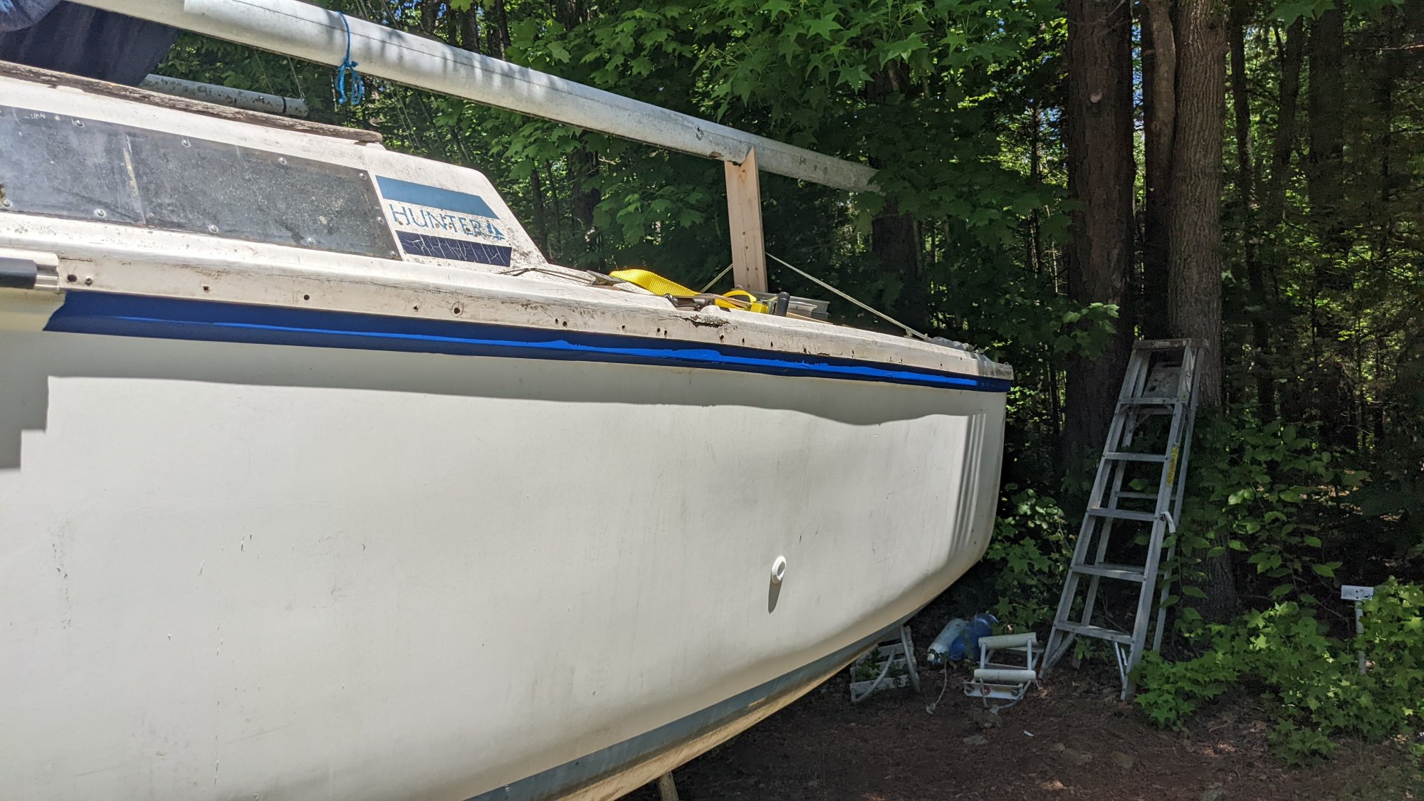

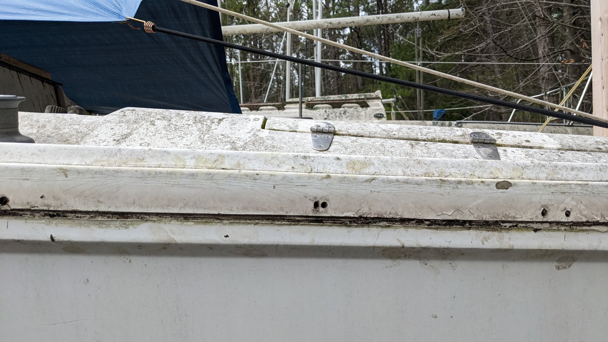

Sunday I discovered that most of the aft deck is loose from the hull.
The club has power; water; a head, etc. It's ~45 minutes from teh house. I'd really like to repair the boat enough to sail it some this season; i.e. in ~2 months.
Do I really need to separate and replace the entire hull joint this season? Since it's aft, could we lift that portion, repair, re-caulk and re-screw it; or are we looking at an entire hull joint repair? FYI- I've seen and reviewed Mark Major's posts about this.
