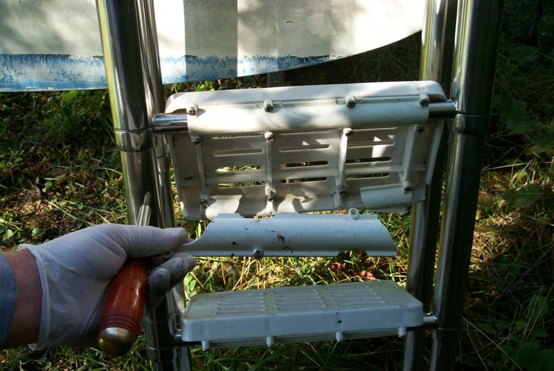

I got a SS folding 6 step ladder that works really nice. It goes way down and I can even get on the boat when its on the trailer. Very handy and makes getting onboard from the water a breeze as the last step is right at my feet when I swim up to it. Here is a picture. Sorry, not a great picture, it shows some damage from the winter, but you get the idea.
