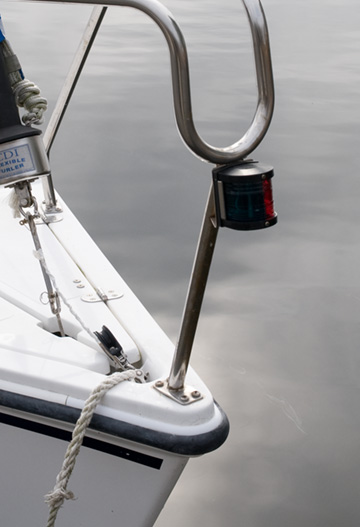

This is how mine is mounted. So far I haven't done anything to damage it. But now that I have a cool new asymmetrical spinnaker I'm pretty sure I'll knock it right off!
