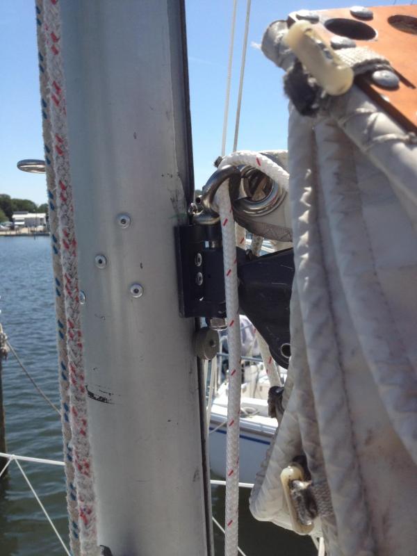

What I thought was strange on my boom config was that there was never anything riveted Into the mast as you are describing. Looks like tjere are holes there for it though. Previous owner had the stop in the mast track to keep the boom from sliding down, thumbwheel type, and a rivet in mast track to keep the boom from rising up. I am using a stainless 1/4-20 screw.
I am using the same rig. Where I questioned all this was when I put the mainsail up and the boom sat below the mast gate opening.

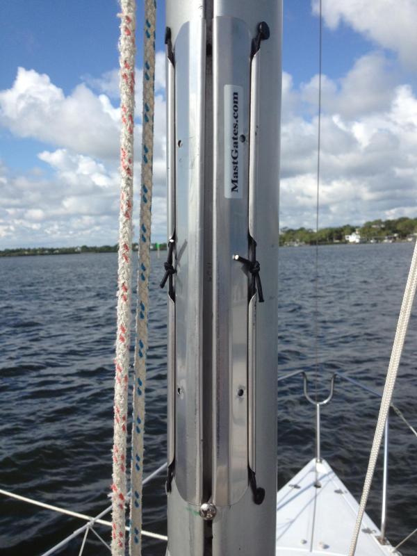

I am working with mastsgates.com to have them make a gate cover so my main hanks stay in the tracks making it easier to raise and lower/flake the main
My mast gate opening is 10 3/4" long. Mastgate said they have never seen an opening that long. Maybe the PO lengthened it.

Isn't the fitting that holds the boom to the mast riveted to the mast - I mean the one you pin the boom to? It looks like it, in the picture on the right in your post. How did the sail stop that is below that get there - or maybe it was always there? In any case, you will be using a gate cover, so that is solved.

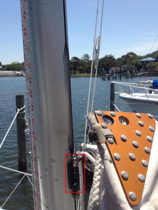

The gooseneck can slide all the way down to the deck if I let it. The area in the red box is not attached by the rivets next to it. Previous owner had to have modified it so he could adjust the boom position from the cockpit.

You were not kidding about how long the opening was.. that looks like maybe 3 to 4 times the length of what is on our mast! The custom mastgate does look good in there.

I couldn't believe it. I measured it twice and it was 10 3/4" both times. Maybe the PO had the other main cut down in length. I have two, and can't remember if I switched them during my "project". I forgot alot more than I thought I would but it is all back together and useable once again!
