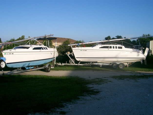

I was "in your boat" doing the same comparisons about 5yrs ago. I went with a Hunter 240 which is basically an upgraded 23.5. I quickly realized that it was just a little too small for our similar criteria in traveling and Fl sailing for a few days at a time. The trailer was a single axle and was actually more difficult to pull than our H260 on a tandem axle. The stowage was very limited and using the head required completely transforming the V berth and being a good sport about using only a small curtain to give mom or guests any privacy while doing the necessaries.
Our 260 filled the bill perfectly for roominess, stowage, real head, running water, stability and having more of a big boat feel while still being no more difficult to trailer. If I could do it over I'd recommend going with a 260. We've trailered all over fl and now keep her on a dock in Sarasota. We'll soon be taking the next jump up in size as our kids are almost out of the house and kelli and I can take more time and do longer runs.
Good luck in your search. Mike n Kelli
Here's both our boats in the yard(whatta wife I have that let me own not one but two boats at once:) )
