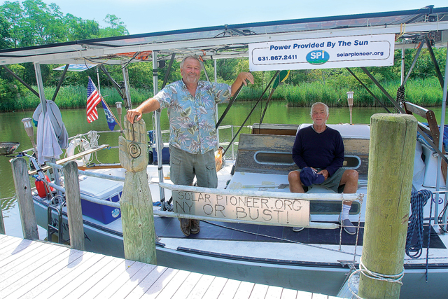

There was a guy on the North Fork of LI who did this. I don't remember what hull he used. He build a super structure for the cockpit and some of the hull and put solar panels on there. He could go 5-6 mph. I never heard him complain about excess motion. He had a solar energy company - Go Solar. I don't know if he is still around.
