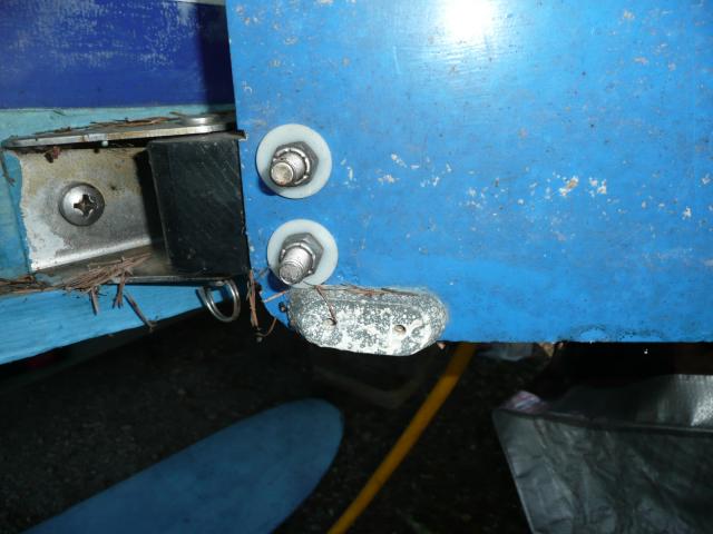

My H26
...rudder plates are also an inch below the waterline (second battery, spare anchor on the aft rail and a 12 gallon fuel tank didn't help). I ground off the paint in one area of the plates and bolted a zinc to the plate. Problem solved, and I didn't have to move the beer.

Here you go Brian
As I'm sure you are aware, clean the plate down to bare metal and don't paint over the zinc. I only put the zinc on one side as the plates are through-bolted.

Thanks MABell and all for your tips! MABell, I have a couple of follow-up questions and would greatly appreciate a couple more details. I'm on the hard now and am about to launch in a few days if the weather improves. How did you attach the zinc? Did you use a bolt and nut (nut on inside)? Drill and tap the aluminum and insert a bolt? Other? When the rudder is fully down, does your zinc location clear the rudder swing (if through- bolted with nut)? Thanks again! BrianW
MABell
Dec 9, 2003
232
Hunter 26 Orygun
Brian
I used two metal screws from the inside through the plate that "self-threaded" themselves into the zinc on the outside. No clearance problem.
