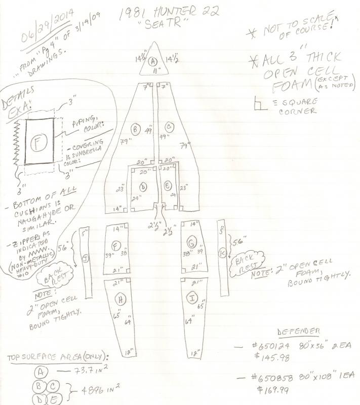

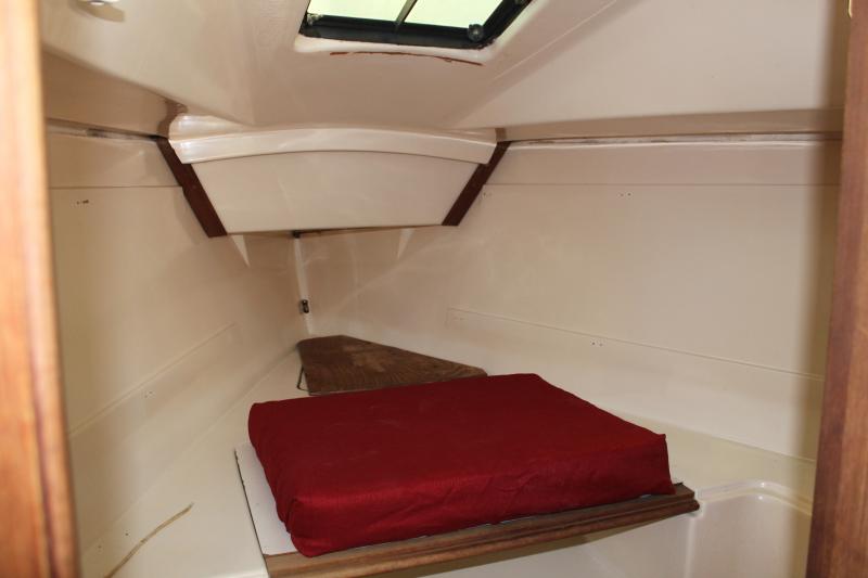

I will be making new v-berth cushions for my 1981 Hunter 22 and am wondering why the existing cushions are blunt on the forward ends and a small triangular filler piece is used. What would be the disadvantage of extending each cushion to the most forward point and eliminating the filler? As an alternative, should the cushions be shortened, and a larger filler be made so it's removal exposes the compartment below?
Advice and recommendations are appreciated.
