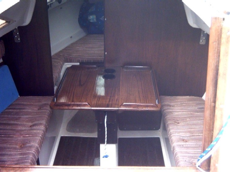

Mark Gibson Hunter H22 Dilly Dally
V-berth small compartment
I mounted my depth finder transducer in the little compartment at the front of the v-berth. I epoxied it to the inside of the hull then ran the wires under the starboard side where the portapotti goes. The wire then goes up the bulkhead. I have my depth finder and Loran mounted on the front of the compression post. From there, I can still see it from the cockpit, as long as the companionway is open.
