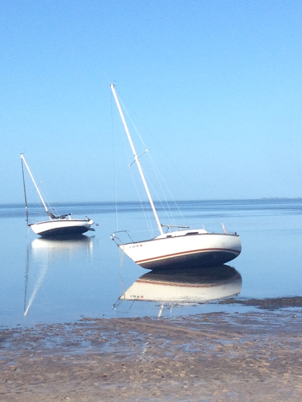

Like this?
I assume you mean the mid-80's H22. I don't do it all the time, as she is in a marina wet slip, but maybe once every couple months she gets dried out like this.
Does it hurt? after 5 yrs or so, i haven't noticed any issues, other than mud on the starboard side. It also gives a chance to clean the bottom.
