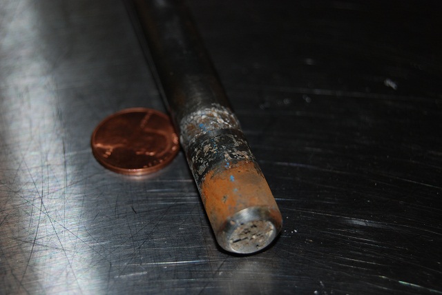

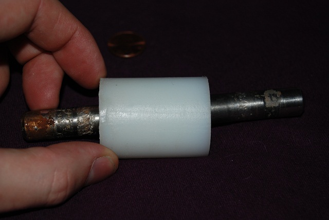

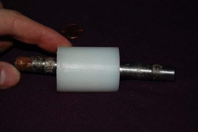

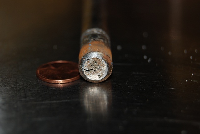

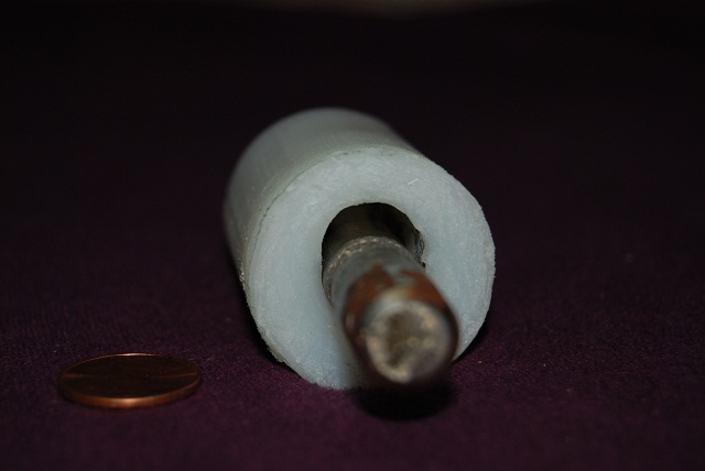

I chiseled out one side of the keel pin/bushing hole and was able to pound out the bushing from the other side. It was heavily worn. Just look at the photos: there's probably a 25 degree deviation that the bushing allows due to wear! Closer inspection of the pin reveals many small pits and tiny holes. Perhaps even the beginning of a crack originating at one of the holes. Going to have to get a new one made up.
