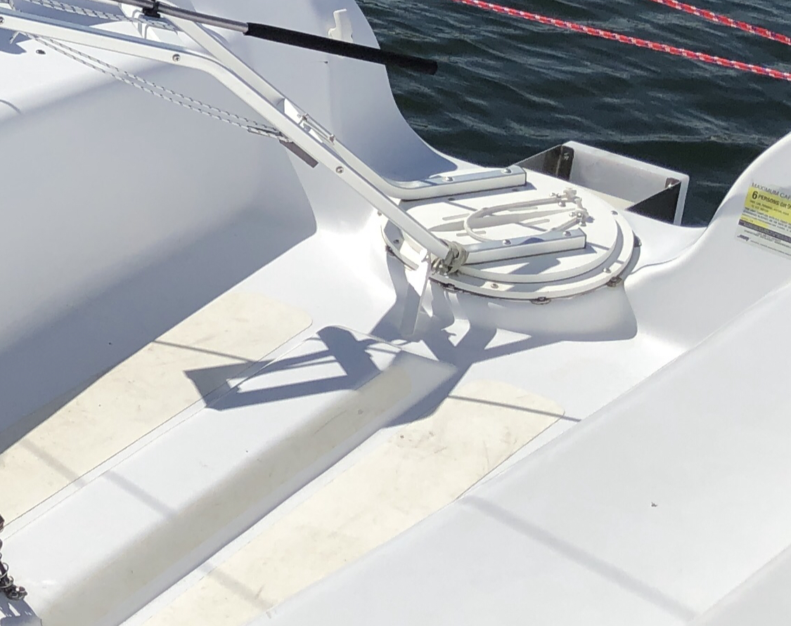

The 216 drains off the transom
While your correct that it’s an open transom that would let a large volume of water out quickly the centreboard slot also acts as the “floor drain”. There is a small lip at the stern so not all water drains there. If the boat is sitting level and idle any water on the cockpit floor would drain out the slot. If however there are cracks etc in the floor itself water could enter the inner hull.
