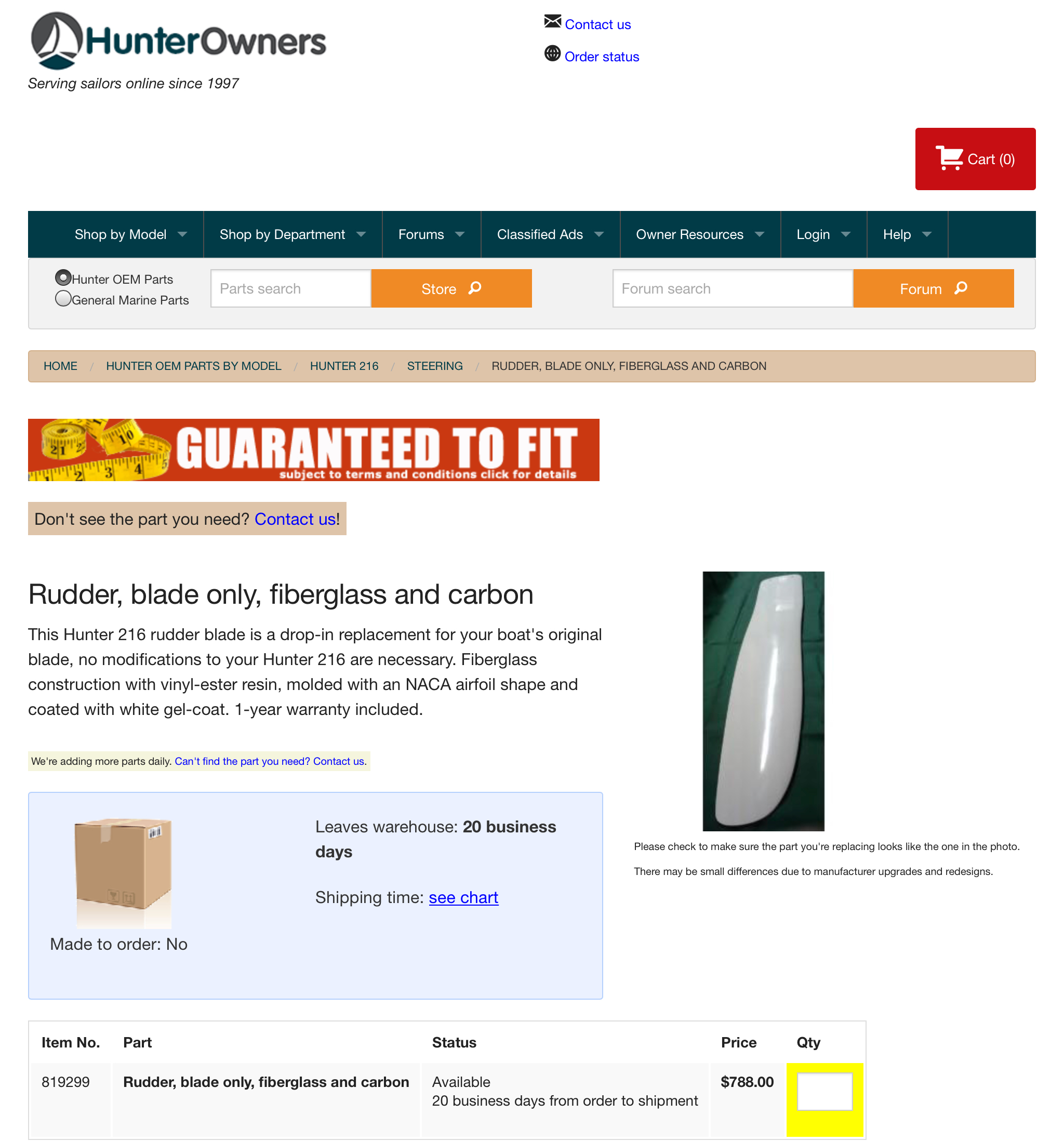

The rudder blade I have needs a little attention (winter project) as there are some nicks on leading and trailing edges from previous owners and a large previous repair on the tip where the blade obviously grounded. After repair I would like to paint it.
My question stems from the fact that I’m not positive if the blade is normal fibreglass construction (which I’m very familiar with) or ACP layup.
Can anyone clarify which of these methods was used in the 2004 model year?
If it’s ACP can I just use the repair tube material found in the Hunter store as the flaws are not structural?
What white paint should I use on the blade and could I use the same paint to touch up a few blemishes on the hull?

Its fiberglass. Easy way to tell is sand it. The ACP doesnt have much smell to it. Gelcoat has a distinctive smell, like pot, weedkiller in home depot. Gelcoat is different.
