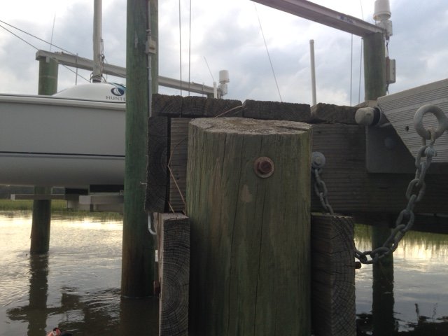

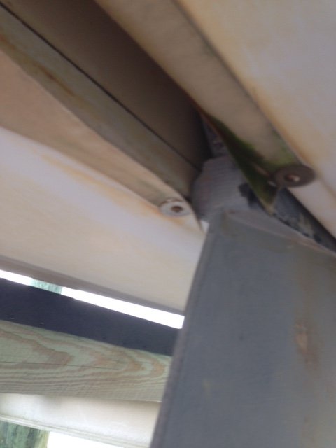

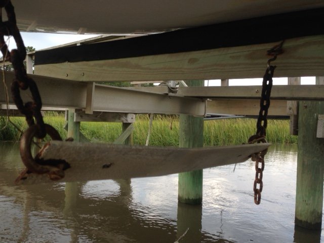

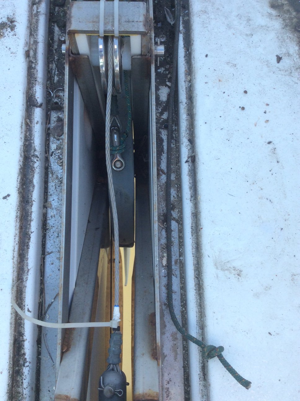

Dave and Chuck...I'm trying to drag and drop images for you guys to see. I have not been active on the site and have dragged one image in but the site is rejecting a second image. The boat is sitting on standard bunks on a Hi Tide four pile gear drive lift, so I can get at the bottom of the keel in a john boat to drill holes for stainless chain plates or shroud extenders to handle the load, like PN did in 2015 post I Goggled. I'm wondering how well that fix has stood up and whether there is a better engineered approach to the fix. Any thoughts from you old pros would be appreciated. Bob
