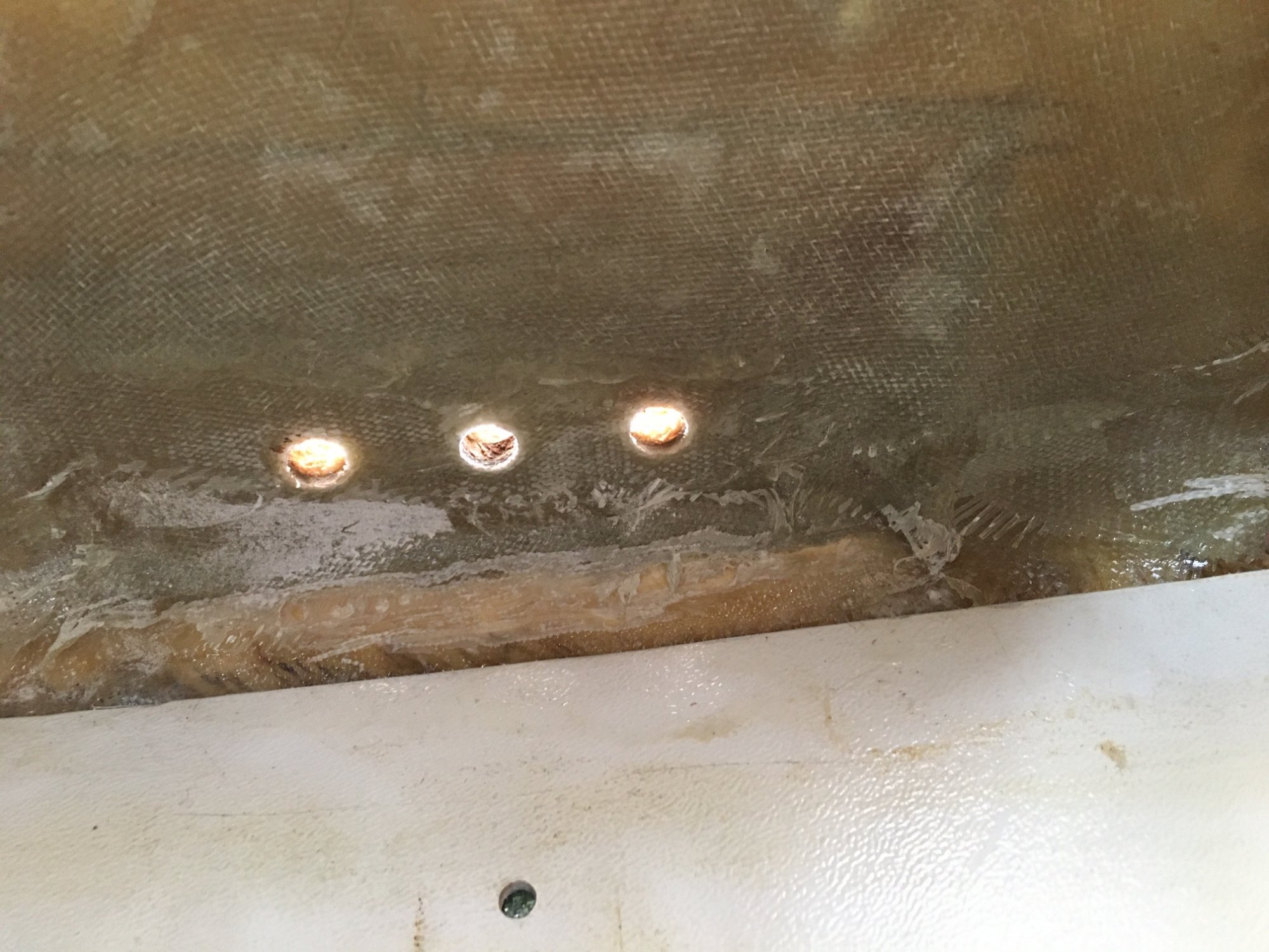

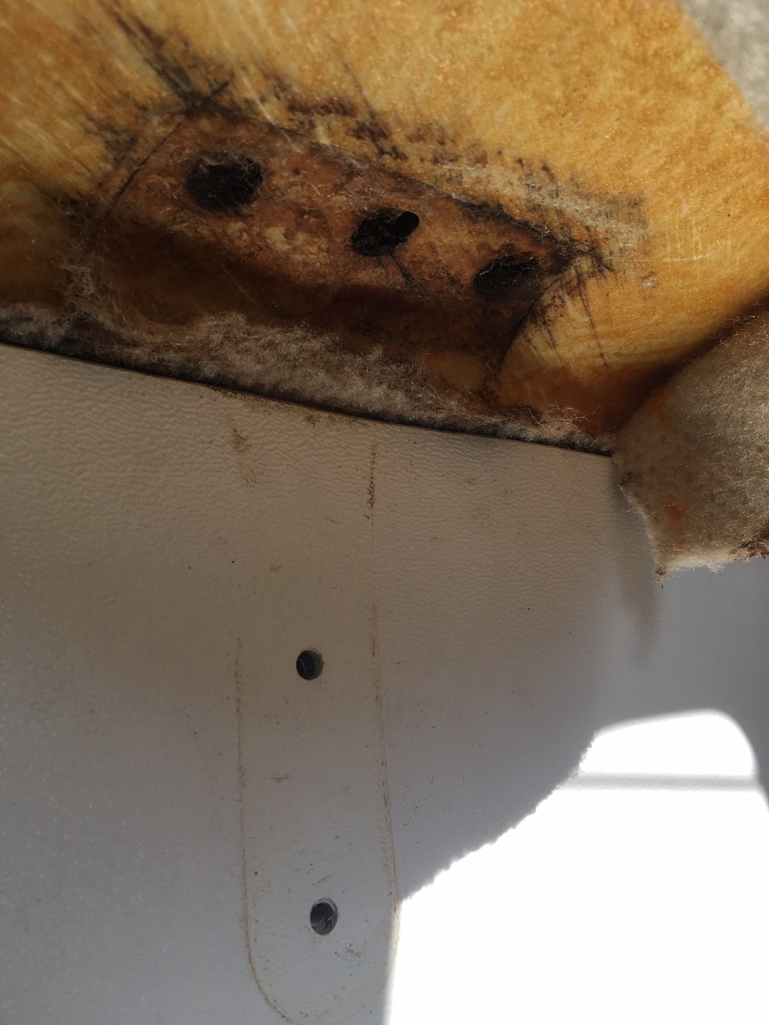

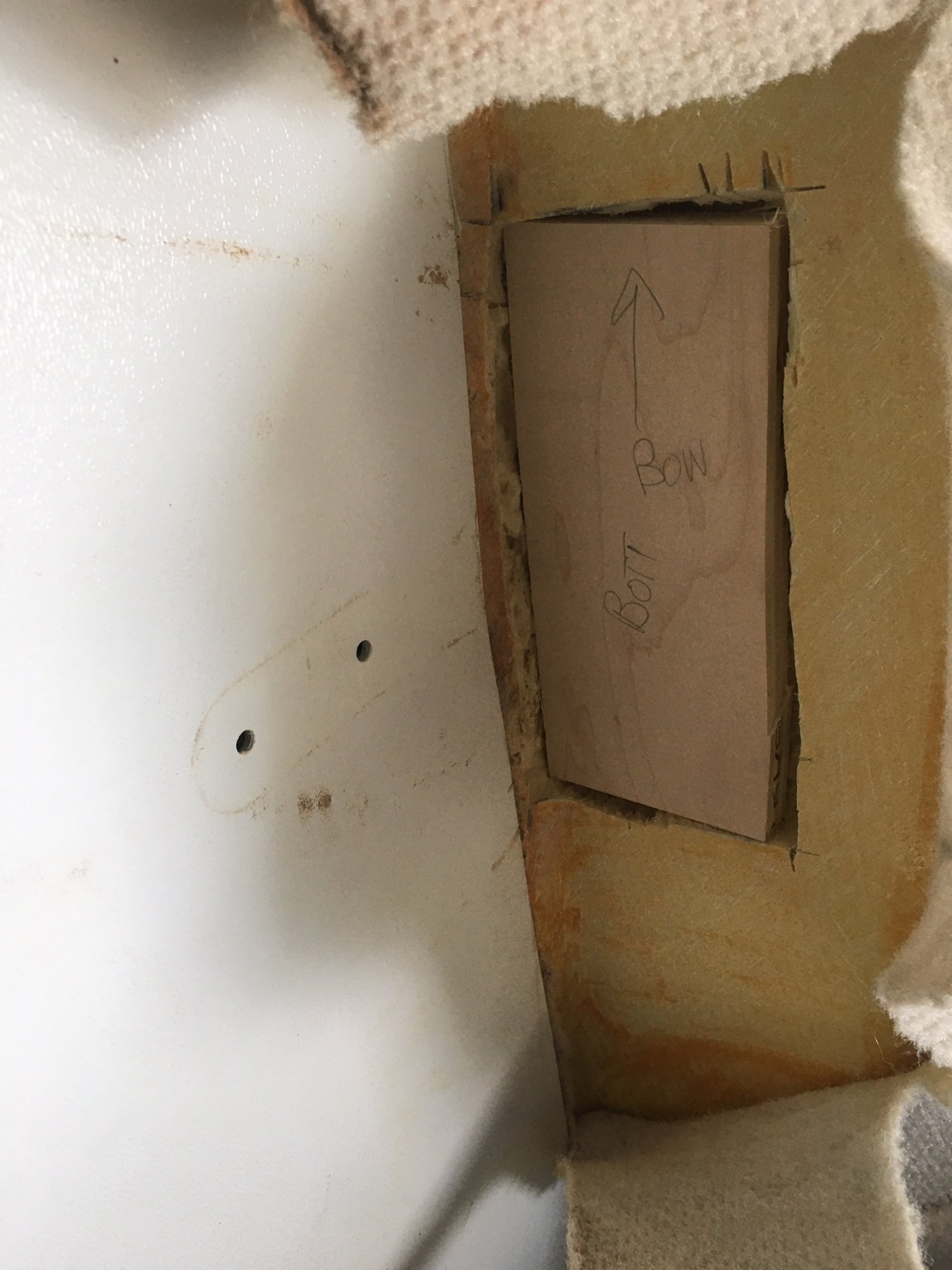

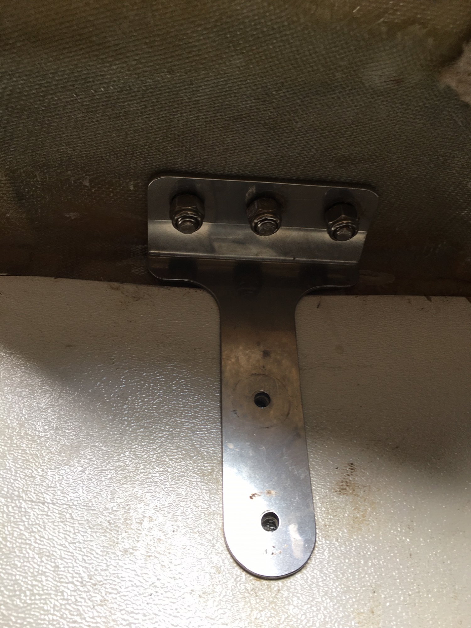

Repair complete. I was shocked at my discovery.
Original construction, ACP deck, 1" woodblock approximately 4"x8" in size, and an inner layer of FRP.
I found, wood completely mush and saturated. THE inner FRP layer cracked and failed, so no chainplate support from the deck probably during the high wind sailing. All the load was being held by the two screws in the hull, which also were bent from the loading.
For repair, I replaced the woodblock, sanded the FRP 4" back, added 5 layers of West epoxy and glass cloth, drilled out for bolts, and bedded the bolts with 4200. I also added 3 layers of epoxy and cloth on the inner hull, redrilled those holes, and added new bolts.
Picture 1. The area after chainplate removal
Picture 2. After removing FRP, and the wet wood.
Picture 3. New wood, ready for epoxy
Picture 4, FRP repair completed, chain plate installed.

If you are seeing brownish stains in the carpet around the chainplates, that is a clear sign that the wood is wet and needs replacing. As far as repair, it was not difficult.

I cut the headliner carpet with a knife diagonally from the corners, I have not glued it back yet, and there will be visible seams but I think it will look ok. if not might just build a cover plate
2) When you pulled the outer double hoop component were you able to see much inside? I was thinking I might be able to probe the wood insert to test integrity.
I would suggest removing the nuts from side hull bolts as well and removing the chain plate, you will be able to tell if the wood is wet through the holes, You can take the chainplate off without removing the bolts, once the nuts are off the bolts can stay in place and the chainplate will come off. With the chainplate off you should be able to see into the holes and poke the wood.
3) In the dimensions of the wood insert, you mentioned a 1” thickness. Was the wood completely flush against the Luran layer or was there some foam between those layers?
There was no foam, all wood between the Luran and the FRP inner layer. I am estimating 1" of wood it may have been less, literally fibrous mush that was wood. Once I had the new wood (3/4 plywood) in place I put the chainplate back on the two hull bolts and there was 1/4 gap between the wood and chainplate, so hence my 5 layers of glass cloth, and a little sanding and the chainplate fit into the exact spot to match the hull bolts. I then redrilled my holes through the wood and FRP for the double hoop u bolt assembly. I oversized the holes and painted epoxy into the holes so the wood will last longer.
4) How did you reseal the two holes through the side of the hull?
I reused these holes. I pulled back the inner hull liner and put 3 layers of epoxy and glass cloth over the holes on the inside of the hull. With the chainplate off the hull liner is not glued down and can be pulled back easily. Once dry I let the hull liner back, drilled through the chainplate and FRP from the inside. They lined up exactly with the original holes. I used 4200 to bed the u-bolt hoops and the hull bolts, so there is a good seal at all hull and deck penetrations.
