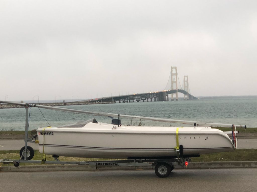

I just picked up a used Hunter 18 for a community sailing club. Sadly I won't be able to sail it till next spring, but I'm really looking forward to it!
Does anyone else here have one? I have an issue with the way the mast bounces in what I think is the factory configuration for trailering it.

You can see in the photo above that I bungeed it, but it was a 700-mile drive home so I had a lot of time to think about a better solution. I came up with something like what you’re saying. I was thinking PVC with a T to hold the spreaders so that the mast won’t tend to rotate while trailering, and a bracket to hold the boom as well.

I'd put bigger wheels on that trailer!
OMG, right?
We were talking about that over Thanksgiving. Why do manufacturers make trailers with those tiny tires? That's the factory trailer from Hunter. I suppose it save a couple hundred dollars and helps them make a price point.
I generally don't drive over 60 mph when towing a trailer and they held up fine at that speed. No heat in the sidewalls or bearings. I guess the total weight is about 1200-1300 pounds.

The mast was bouncy enough, I didn't like the idea of tying the boom to it. You can see in the above picture that I put the boom in the cradle on the stern, but laid it on a board on the floor of the cockpit.
