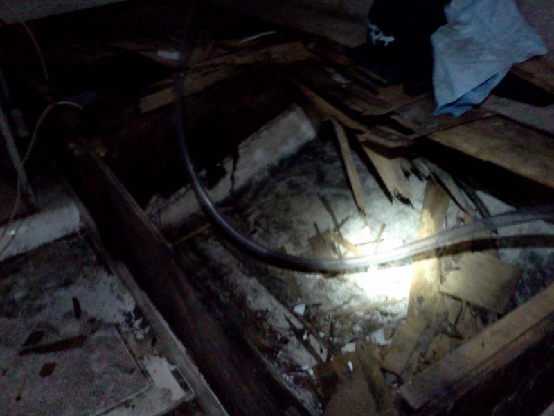

Hunter H23.5 barkley
My H23 had so much water in it that it used the sink drain as a over flow. The water line inside was even with the sink bowl. I have no idea how long it took to get to that point or how long it stayed there. But I assume it was a very long time. Both the cockpit and anchor locker had drained directly inside due to the drain tubes being broken (rotten). I mentioned this to a friend who said it was hard to believe the trailer didn't buckle under the weight. I know that there was concrete blocks along with the jack, which may have been what saved it. Or it was on the water during the cabin flood, who knows. but it was a mess.
