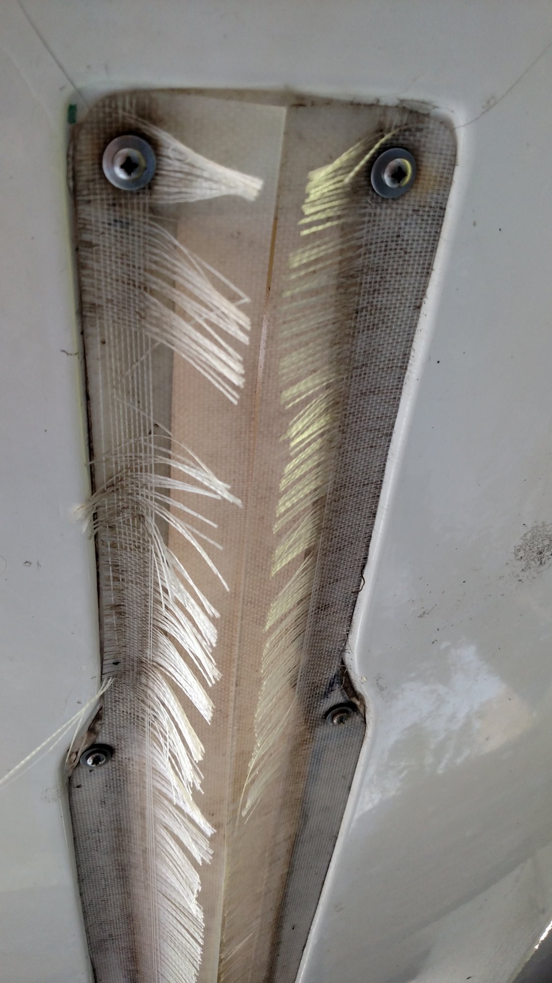

The repair issue is one side of the flap got damage somehow and the thread is slowly unraveling and sheading. I periodically have to cut thread clumps off. At some point I assume I'll lose most of one side. So from your description I assume there's double sided tape between flap and hull with a line of screws thru the flap and tape into the hull? Assuming the board remains up for this job I should be able to do the work while on the lift. I like your suggestion on shallow water flip - avoids point loading the gunwale. My last 2 questions are geared at inspecting and possibly working on the leading and trailing edge of the board as a way of addressing board hum at higher speed.

Status update on my centerboard flap issue. After getting in the water with boat on the lift I got a good look at problem (see attached). The flaps are a stiff plastic with fiberglass cloth bonded to the outer surface. As you can see the cloth is de-bonding and subsequently the fibers are unraveling out of the weave. The replacement flap set (comes as 2 pairs) @ $180. Given the remaining plastic is sturdy and fairly stiff I'm not sure why they bond the cloth on to begin with? Subsequently I trimmed off the de-bonded cloth and fibers and plan to run it as is trimming additional cloth as needed.

The “flaps” on my 216 are just stiff plastic. As far as I know they are original and the boat is 2004 so I don’t see the purpose of the fibre either.
