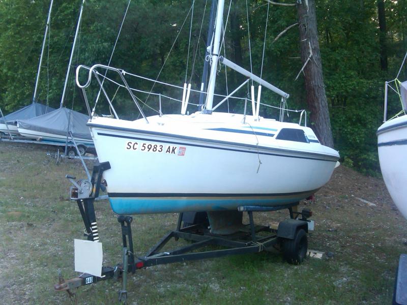

I just started sailing and just bought the boat. It come with a metal boom vang instead of a normal vang. Is this something I should replace with a normal vang? I'm attaching a pic of it. Appreciate your help.

As long as the ridged vang is operational it's as good , or better, than a soft vang ( I can't tell from the picture ). With it you can eliminate the topping lift and I don't see one on your boat. That's a good thing because the full batten main on a 18.5 has a large roach and the topping lift is a major PITA .

That's probably doing nothing!
Here's what I suggest ( if your budget allows ):
A boom kicker and soft vang ( that's what I had and have on my present boat ) or a ridged vang. If you go with a ridged I suggest Garhaurer ( best bang for you buck, by far ). You can't vang sheet without a vang and on that boat being able to vang sheet is important if you want to reduce heel and increase performance.
While you are at it I'd suggest you install a cunningham. It's simple and not very expensive and in my opinion a " must have " for any sail boat.
I know it seems the expense goes on and on but there is a huge difference in fun and satisfaction in sailing a boat that is performing at it's best or performing like a pig.

Thanks for all the advice, Ken and Dave. I really do appreciate it. I had a feeling something wasn't right about the vang but I didn't know what. Definitely will be looking at getting either a boomkicker or a rigid vang.
