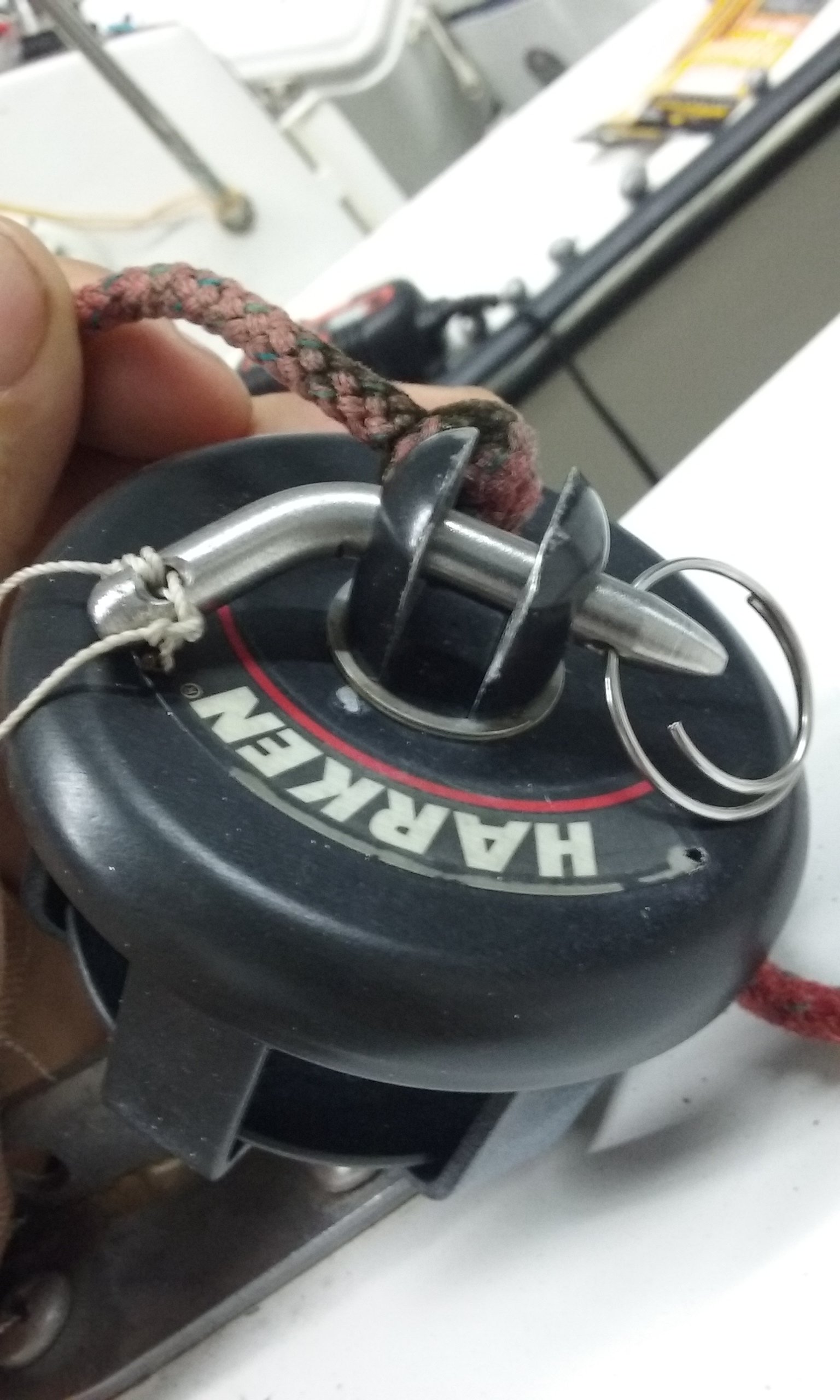

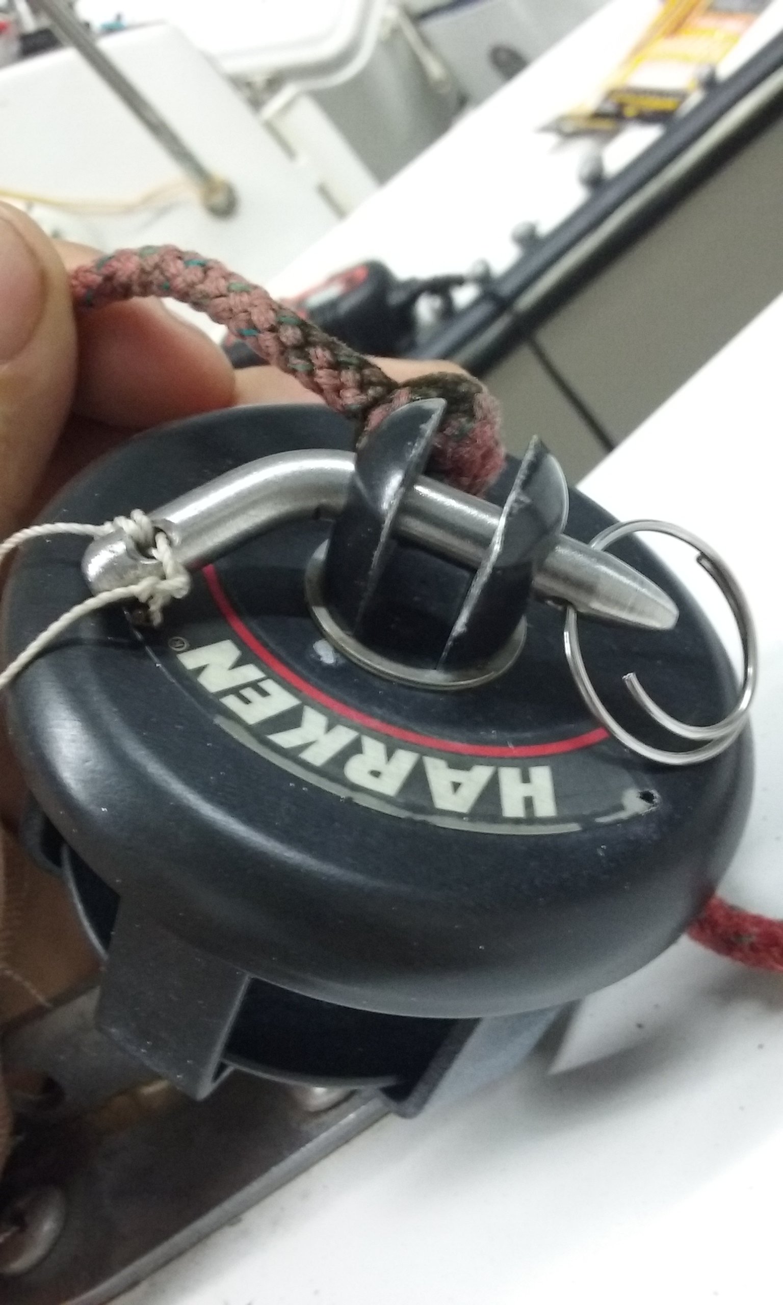

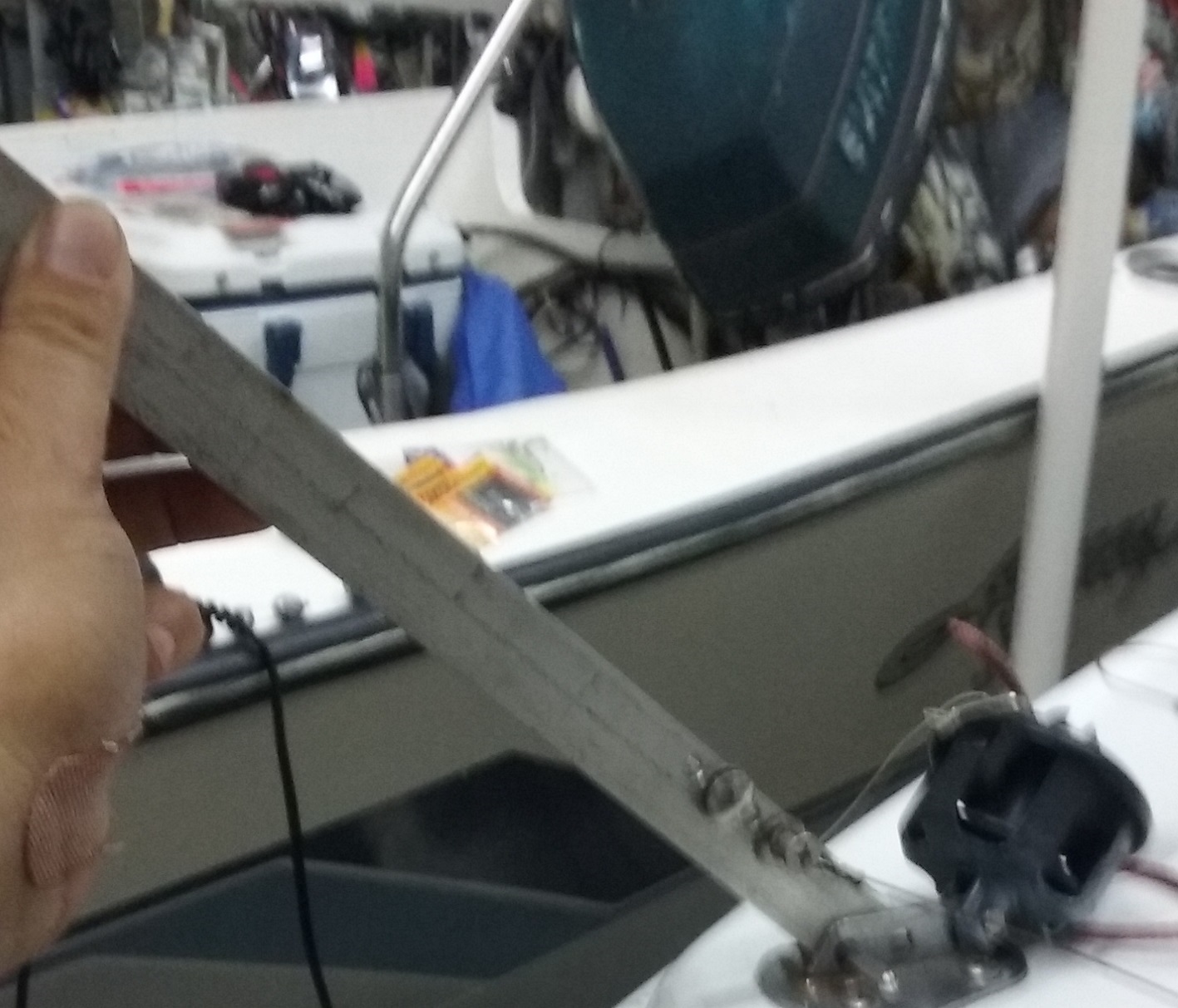

I ran into the exact same difficulties when trying to put up the mast on my 170. I've done two things so far to try to make the process easier. I made a pin with a good taper on the nose & enough of a handle to grab firmly. I also made a leverage tool that I plan to hook into the bow hardware & use to pull the forestry down tight with a short cable that goes through the eye of the jib & connects to the bow cleat on the other end . I'm not going to have time to try out the leverage tool until the end of this week. I'll report back on how well it works.
