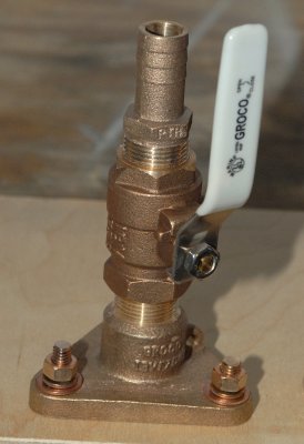

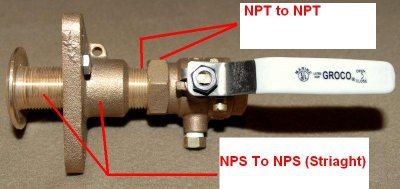

I plan on replacing all the thru hulls on the boat (H34 ' 84) when I put new bottom paint later this year (after hurricane season) and would like to know the hull thickness where the galley, vanity, and the waste valves are currently. I am assuming there in the same places on these early h34 boats? I plan on using the configuration in the picture below and replace all the gate valves. I'm preparing a list of things to replace while the boat is out the water and getting the supplies ahead of time. Any help would be appreciated.

Thanks for your replies, I was just wondering which thru hull to order so I would have the correct lengths in hand when we pull the boat. Most of the 1 1/2" vlaves and thru hulls no one stocks and takes several days to arrive and just wanted to be prepared.

There are two ways to handle the length. As Bill mentioned most are 3". The seacock has a little over a 1" depth of threads. I suppose you could make up the difference with a thick mounting pad(plywood soaked in epoxy in my case). But usually we just cut them(with the nut on so it cleans the threads when you take it off). Also mentioned was studying this:

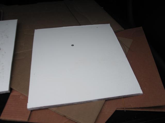

Thats what I'll plan on doing is buying bigger and cutting it down to size. I also plan on removing the wood spacer and installing 5/8" thick fiberglass that I just picked from one of the repairs yards and epoxying it to the hull.
Just like the pictures show.
