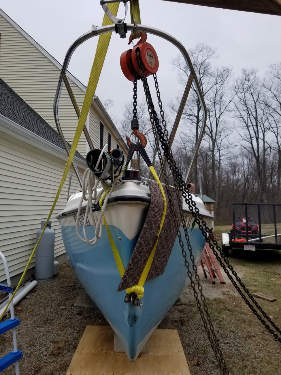

Even with the weight on there should be little or no indentation. The liner should hold the shape. The factory tied the liner the the hull with one layer of sloppily applied glass and resin. Basically to keep them together. Not for stopping compression. There might be more going on. I replaced some of mine when I found them separated. Up by the v-berth and cabin seats. West System epoxy and glass cloth. Probably from pounding in our New England waters. It made a difference in stiffness when pounding in weather. The front edge of the bunks seems to push the hull in a little when on the trailer but not much. There is some flex in the hull. If you need to lift I did this(see pic) Less than $100 to make. Having a chain fall helps.

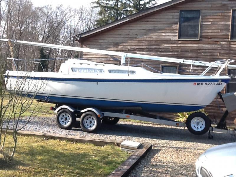

How long and wide are your bunks? Not the best picture, but you can see how long my bunks are. Spread the load over as much area as you can.
