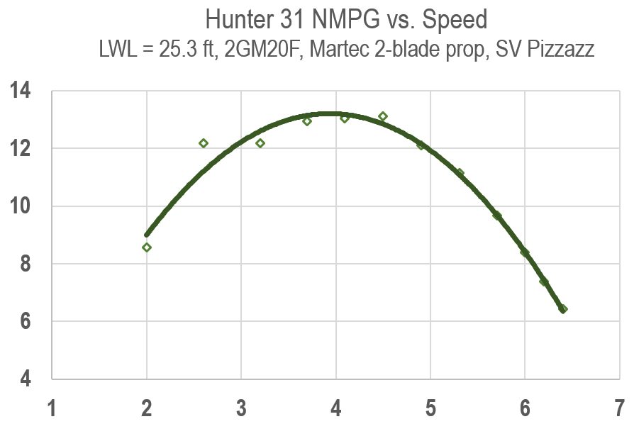

I calculated average nmpg for my Hunter 31, 2GM20F engine. This was in calm water in the marina. I usually budget 10 nmpg. If you are going into the wind in big waves, you should expect higher consumption.

That is a typical engine fuel consumption curve.
Note the "Sweet Spot" at 4 knots. @Pizzazz would go 13 nm on a gallon of fuel.
The peak of that curve can be assumed horizontal, and you see the consumption is very slight changes for speed of 3.5-5.5 Knots. Thus, find the "Sweet Spot" . I found mine at 70% of WOT.
Since in the Tennessee River, you will not be fighting winds or sea state, when motoring.
Many Captain's use 4-5 knots average speed in planning distances traveled.
Jim...

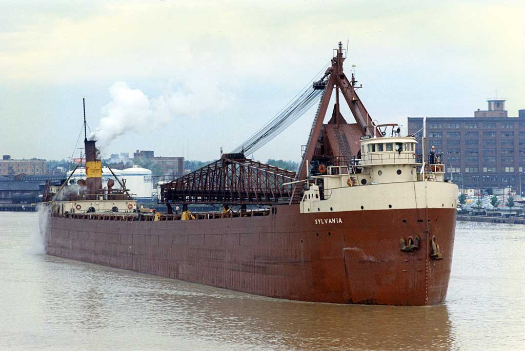

well stu, i work on a ship that had an engine with 3 different sizes cylinders. yepper.
S.S. Sylvania. built in 1902, had a triple reduction steam engine. pretty standard for the day. 1st cylinder maybe 12",second about 24" and the last was about 48". the exhaust from the first cylinder powered the next one, the exhaust from the 2nd cylinder powered the last one. now maybe, i have the sequence reversed, don't know.
580' long, 1200 HP, wind her up and maybe hit 8knts. going up the rivers was quite slow.
the joke aboard was that if you blew too long of a salute you would slow to 6knts. 180lbs low pressure boilers, hand fired coal.
one year we ran 201 loads of coal from toledo to detroit
