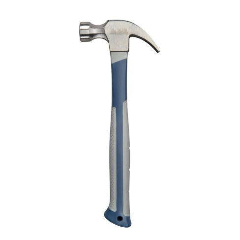

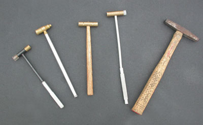

You need to test the hull with a hammer ....

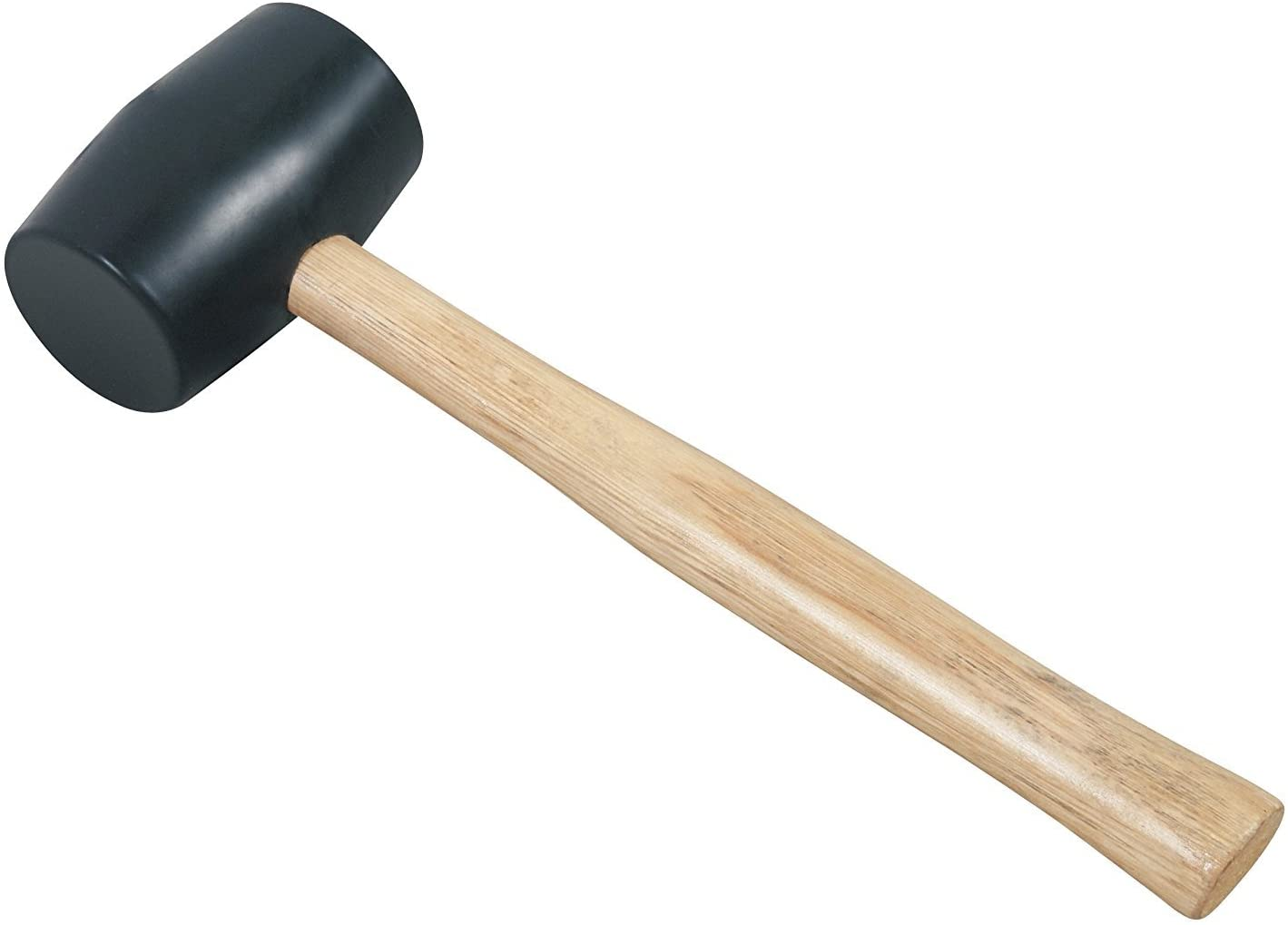

I think @jssailem means Rubber mallet
Not
23,253
Tapping, or percussion testing, is an extremely useful non-destructive inspection technique.
I was suggesting something like these.
Definitely
the imaged Claw hammer.
Never used a rubber mallet. Doubt it will serve the intended use.
As so often is the case it is the craftsmanship and knowledge of tools to utilize that yields a solution.
12,591
I've used a rubber mallot. A solid hull will ring (hum) and a delaminated one will thud.

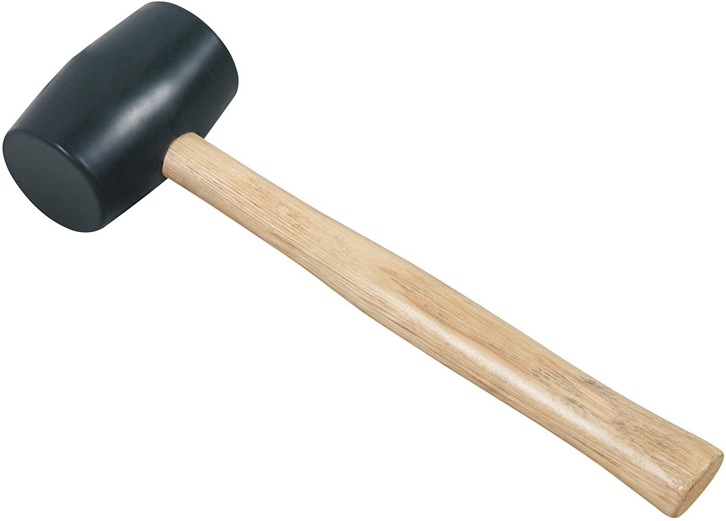

Not
View attachment 204290;)
