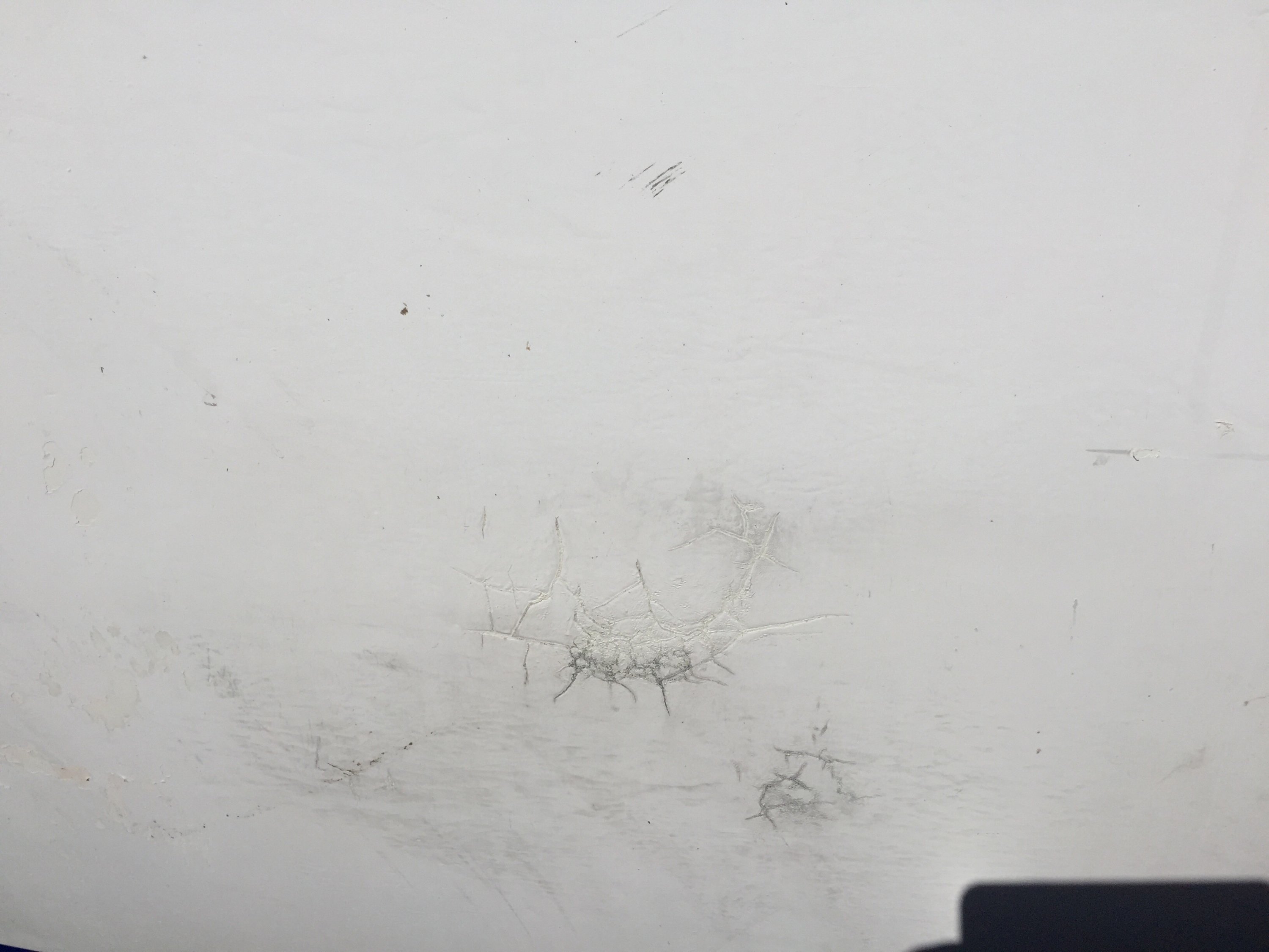

I noticed these marks on the side of the hull of a very well used sailboat I am thinking of purchasing. It looks like something that was caused when the boat hit the dock. Is this something that requires repair, or is it just an unsightly mark? Thanks in advance. I am new to all of this.

What type of boat? It's possible that water could have gotten in some of the cracks which is less of a big deal if the hull isn't wood cored.

I'd check on the inside of the hull where that is, if it is accessible.

I would not worry. I would hope it is only a few inches. That spot could be a compression from a hit. It looks like several hits, maybe against a dock that did some gouging. Maybe you could fill it and gelcoat it. At worst, you would need to cut it out, feather it, and re-glass it. It can be done easily. If it is several feet... it just means more work. Hull damage is repaired. Press on it to see if it feels stable and strong. That will tell you if it needs more than filling and gelcoat. Make sure the price reflects the need for repair.

The picture doesn't really tell the story. But that may be a hard spot i.e. where a bulkhead or other structural element connects with the hull. If so the hull in that area may have water intrusion or softening. So yes it requires expert evaluation.

The broad horizontal gray streaks and scratches are dock rash probably caused by a very dirty fender or no fender and rubbing up against the dock. Those are not a big issue, some time with a rubbing compound and a buffer will take care of them.
More concerning are the cracks radiating out from the large area in the center and to the lower right. How large are they? They look to be the result of a direct impact with something with a fair amount of force. It may be fairly shallow, i.e., only affecting the gel coat or could be more serious causing the glass to delaminate.
If you can sound the hull, it will tell you a lot. Take a hammer with a plastic face or a screwdriver handle and tap on the hull. It should sound solid with a sharp tone. As you hammer closer to the damage listen carefully, if the sound doesn't change, not a problem. If the sound becomes dull, it means the underlying glass has become damaged and should be repaired.
Assuming only minor damage the repair shouldn't be difficult or too costly for a DIY repair. Grind out the damaged glass, lay up new glass and gelcoat or paint the area. Check the West System site for ideas on repairing.

That is what a poorly executed laminate repair looks like. Too much filler in a single application caused it to shrink and crack. I would want to know how extensive was the pre-repair damage, including other areas of the hull. A short haul is in order.

I agree with Gunni. That is a failed repair... If you can't research the problem or get a local technician to give you a repair estimate... I'd pass on the boat...
