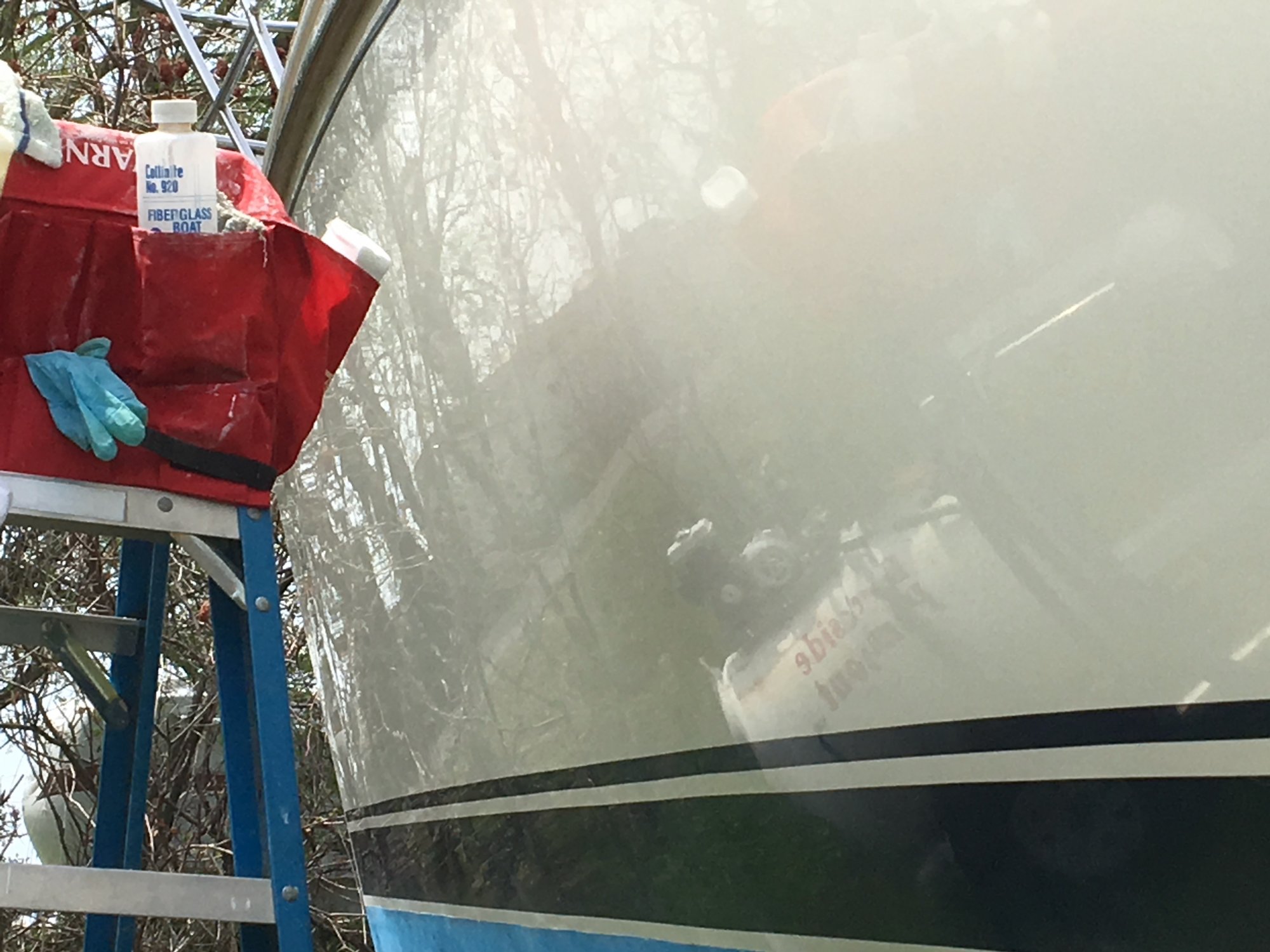

I've used Collinite for years by hand. It goes on easily and buffs out to a nice shine. Every few years I'll get out the angle grinder/buffer and do the hull with 3M Cleaner Wax followed by the Collinite boat wax.
Setting up some scaffolding makes the job much easier. I built a small platform (16" x 8 ft) out of plywood and 2x4s that is placed between 2 step ladders. Works well and doubles as a work bench.

Collinite fleetwax and a Mikita buffer. Great results, easy to use except the buffer is no lightweight.

I get my waxing, compounding, and polishing advice from MaineSail on the Sail Net forum. His instructions have helped me make faded topsides gleam like new. Here's a link:
Based on MaineSail's recommendations, I stick with Collinite Fleetwax. He's done the actual testing of all the best waxes and has no bias.
And, he says no buffer is needed. Just use micro fiber cloths.
If you're compounding or polishing (not to be confused with waxing), then a good polisher/grinder with variable speed down to 1200 rpm or so is best. Random orbital on gelcoat?....no.
If you wax your topsides and aren't satisfied with the results, it's not the wax or the application method. It's the gelcoat. When I wet sanded, compounded and polished my 1996 Catalina 28MKII, the topsides gleamed to the point where the wax gave no additional shine...just protection.
If you're at an age where you want some assistance with the waxing (I'm in that club), would you rather lift a cloth over your head or a buffing machine?
Each spring, I see guys in the boatyard standing on ladders, running buffers. Waste of time. Might as well swing a dead chicken over their heads. The only real path to shine is to evaluate the condition of the gelcoat, then wet sand, compound, polish, and wax.
All that labor isn't everyone's cup of tea. Shine may be overrated, anyway. If I didn't live so close to my boat, it probably wouldn't be as shiny.
So, shy of the entire laborious process, clean it, wax on with the applicator, and wax off with the micro fiber. You'll see some shine, you'll have some protection, and the results will be more temporary than you'll like.

I follow MaineSail's advice with regards to compounding, polishing, and waxing.
Usually do mine every 3 years on haulout; therefore, I usually compound lightly with 3M compound, followed by 3M finessit, Meguiars #9, & finally, Collinite paste wax. If you are waxing annually, I would think that rewaxing would be sufficient without compounding. If there is a slight bit of haze on the gelcoat, perhaps finessit or Meguiars #9 would be adequate prior to waxing. MaineSail also recommends Presta Chroma for glazing, prior to waxing. Makita polisher is the best, in my opinion, lots of pros use it for compounding and polishing. Have had it for approximately 20 years without any problems. It is heavy, so have some Ibuprofen on hand, after using it the first day!
