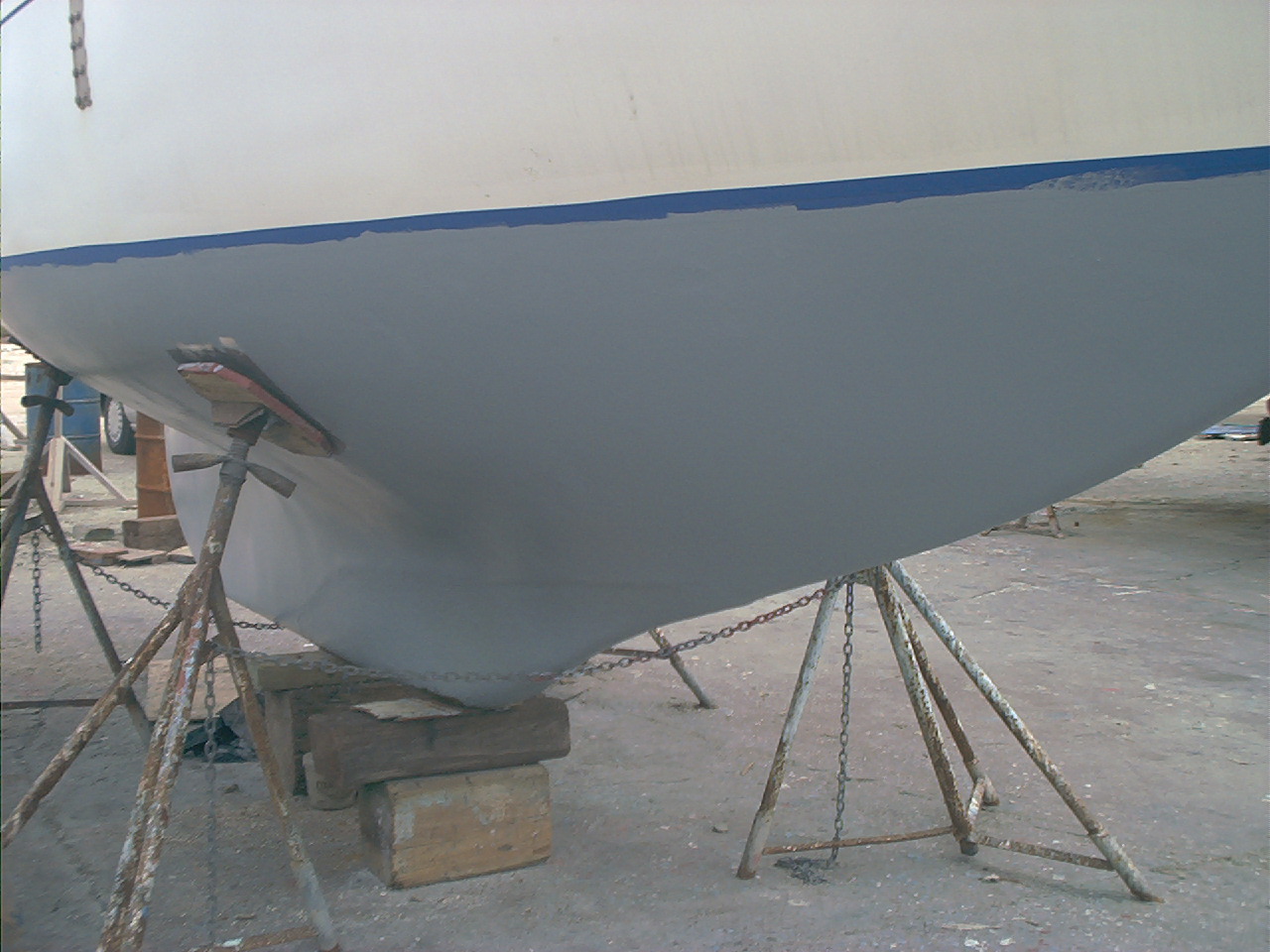

I believe Interprotect calls for a certain micron thickness, which the yard must feel they can reach with two coats. I rolled mine on and did 6 coats after scraping the entire bottom down to gelcoat. I don't believe our O'Day is vinylester so not sure what other factors may be in play there. I did the scraping during the winter, outdoors, and applied the Interprotect when the temps were in the 60s in the spring. I removed 20+ years of ablative bottom paint and VC-tar which was applied when the boat was new. There were no blisters at all when I scraped it, and I have been very happy with the Interprotect, which we cover with VC-17.
