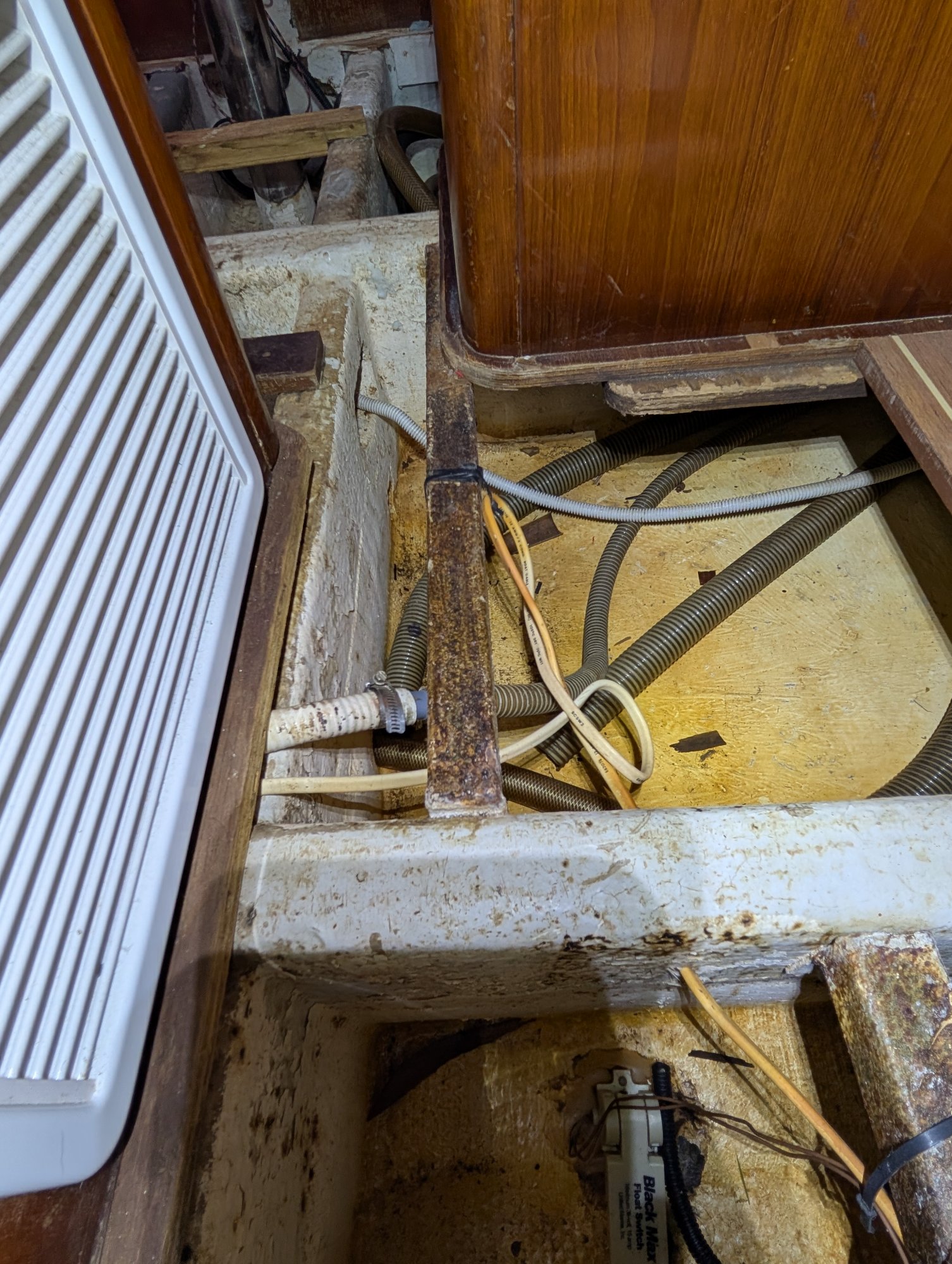

Hello All. I have water intrusion coming in after my boat had sat on its keel during winter low tide. It appears to be coming from some smallish cracks located directly below the staircase access to the engine, where there is a raised fibergalssed support for the bottom of the stairs. I took her out sailing on a light day yesterday to get an idea of the damage. Upon return there was about a gallon of water in the boat. I remove it, came back the next morning and noticed some water , but not a lot. I need to do this repair myself as much as possible and need some guidance on how to tackle this problem.

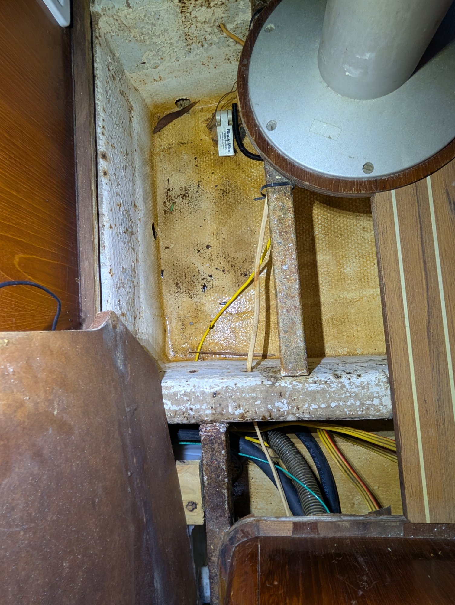

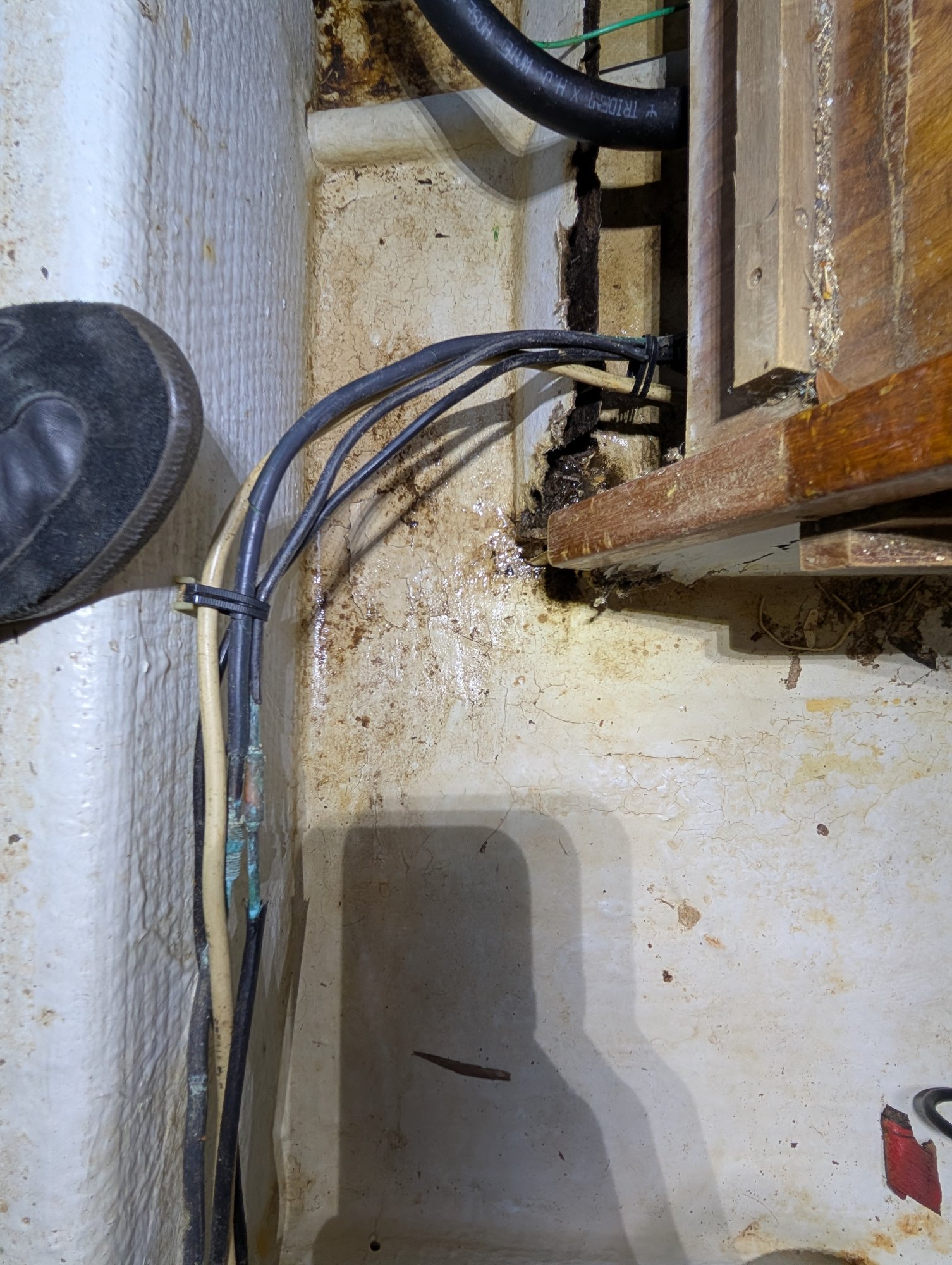

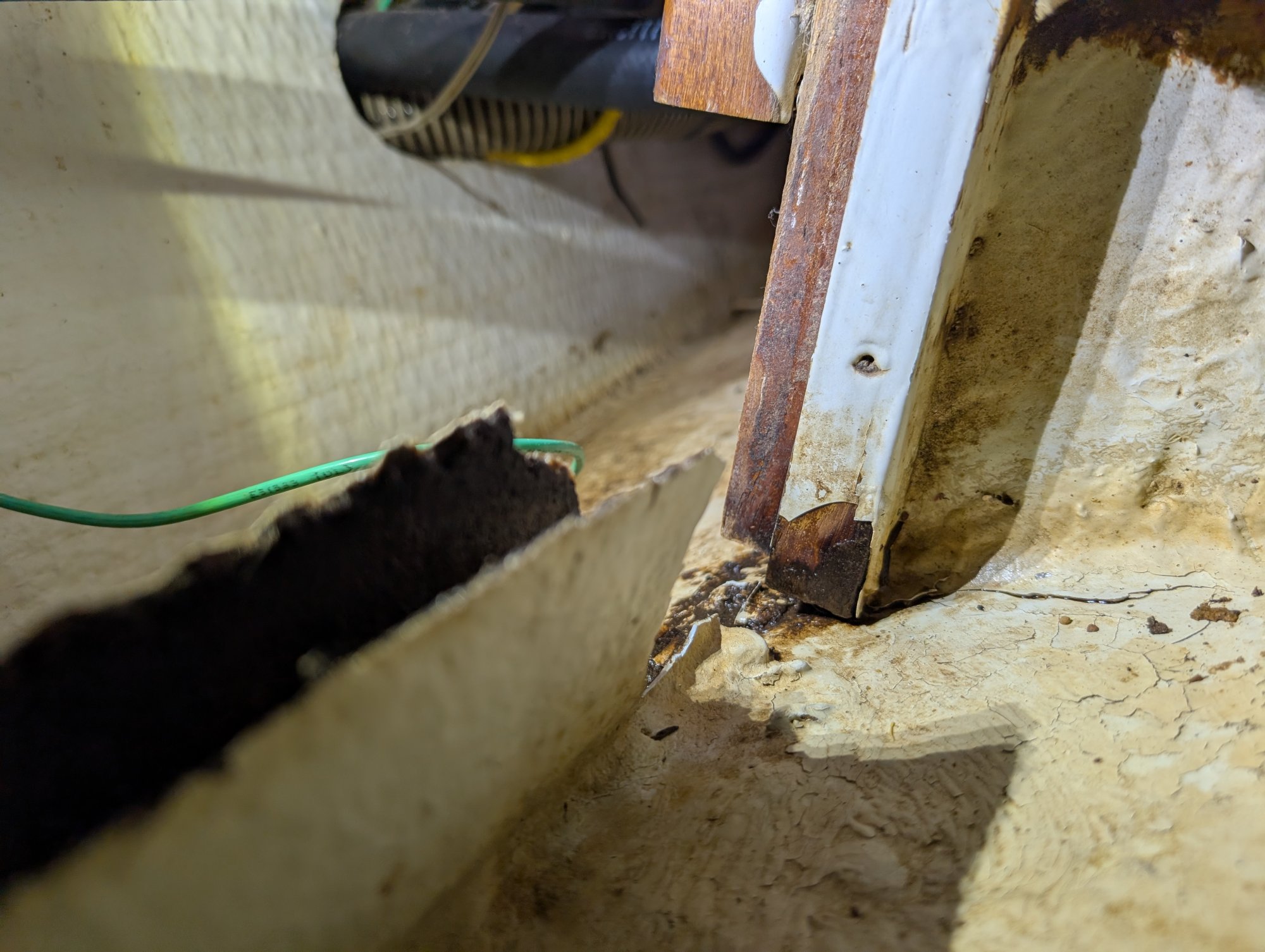

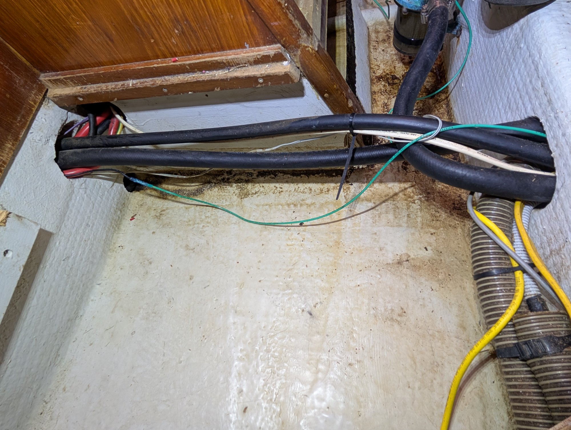

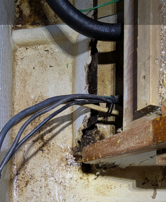

The [pics I posted show the bottom of the stairs as well as other areas for damage.

It appears to me to be a serious structural issue at the joint weakened as a result of whatever caused it. Hard to tell more from a few pictures. Putting a bandaid on it might temporarily fix the symptom but hiding or pretending the structure damage isnt significant isnt wise (or safe). Plus latent water in that area of th hull can cause more long-term deterioration.

Any idea what happened to the rest of this panel that's cut off halfway up?

Has the boat been run hard aground? It is hard to tell from pictures alone, however, some of the damage looks like the damage that comes from a hard grounding. In a hard grounding one of the main areas for damage is at the aft end of the keel. The impact causes the front of the keel stub to be pulled down and the aft end to forced up.
Sitting quietly on its keel during a low tide is not necessarily a problem if the water is calm and the bottom soft. If, on the other hand the bottom is hard or rock and there is any wave action, the repeated pounding on the bottom may have caused damage that we can't see until the boat is hauled.
There are a number of issues in this boat including sketchy wiring, rotted structural members, and water damage. It would be best to hire a surveyor to inspect the boat and determine the extent of the hull damage. In this case given the boat sat on its keel, the surveyor may want the boat hauled. A good surveyor will advise you on the extent of the damage and ways to repair it. It may be possible to file and insurance claim to help cover the cost of this expensive repair.

Do you see water coming up through the crack? What does the hull-keel joint look like? Is the water salty or fresh? Is there any water coming from the shaft seal?
The interior of the boat doesn't have gelcoat, it's painted. So any crack is structural, not cosmetic.
Besides the crack, there seems to be part of the grid structure that's been cut away (the black parts with hoses coming over it)? Difficult to tell remotely, would have to be on the boat.
Do you have insurance? Was the boat grounded on purpose? The boat is not meant to rest on it's side. This imparts a lot of flex and side force on the keel and grid system.

In your case, the crack appears next to an area of the boat that appears to have been cut out at some point (the black / rotten parts) ? Is that area glass? wood? Did it come cut out like that from the factory? I don't see grid delamination. Does the crack go all the way across to the outside of the hull? Have you dived the boat yet?
Were the holes in the grid cut by the factory or is that something that was done by an owner? Normally, wiring going through a fiberglass member is protected from chafe, which I don't see.
Some wires have butt connectors in the bilge, that is a huge no-no, and they are corroded.
Some of the hoses and wires are unsupported. They should be secured every 18 inches.
From 1000 miles away, it looks like some of the wiring was made with household wire. Household wire should not be on a boat (it's stiff and brittle) but most importantly, the jacket may not be oil resistant.
Time for haul out and assessment by a yard that's done this kind of work before. This is not a DIY project if you've never come close to doing anything like this before. Your (or a future owner) safety is at stake. Have you contacted your insurance company ? At a minimum, hire a good surveyor, shipwright or fiberglasser.
Sorry to be the bearer of bad news. This kind of issue does not lend itself well to remote assessment, you need an expert on the boat. We really can't tell from the photos if this is a DIY $10, $1000 or a professional $70 000 repair....
