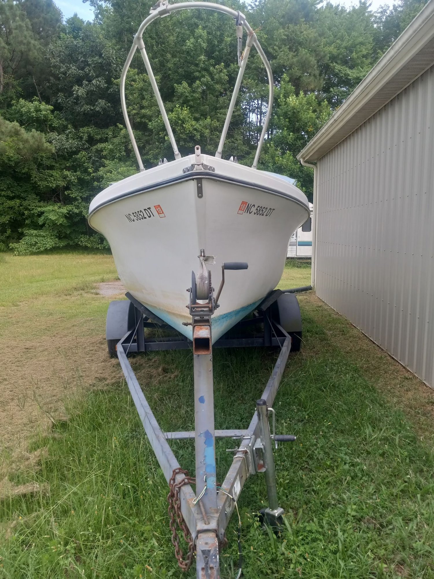

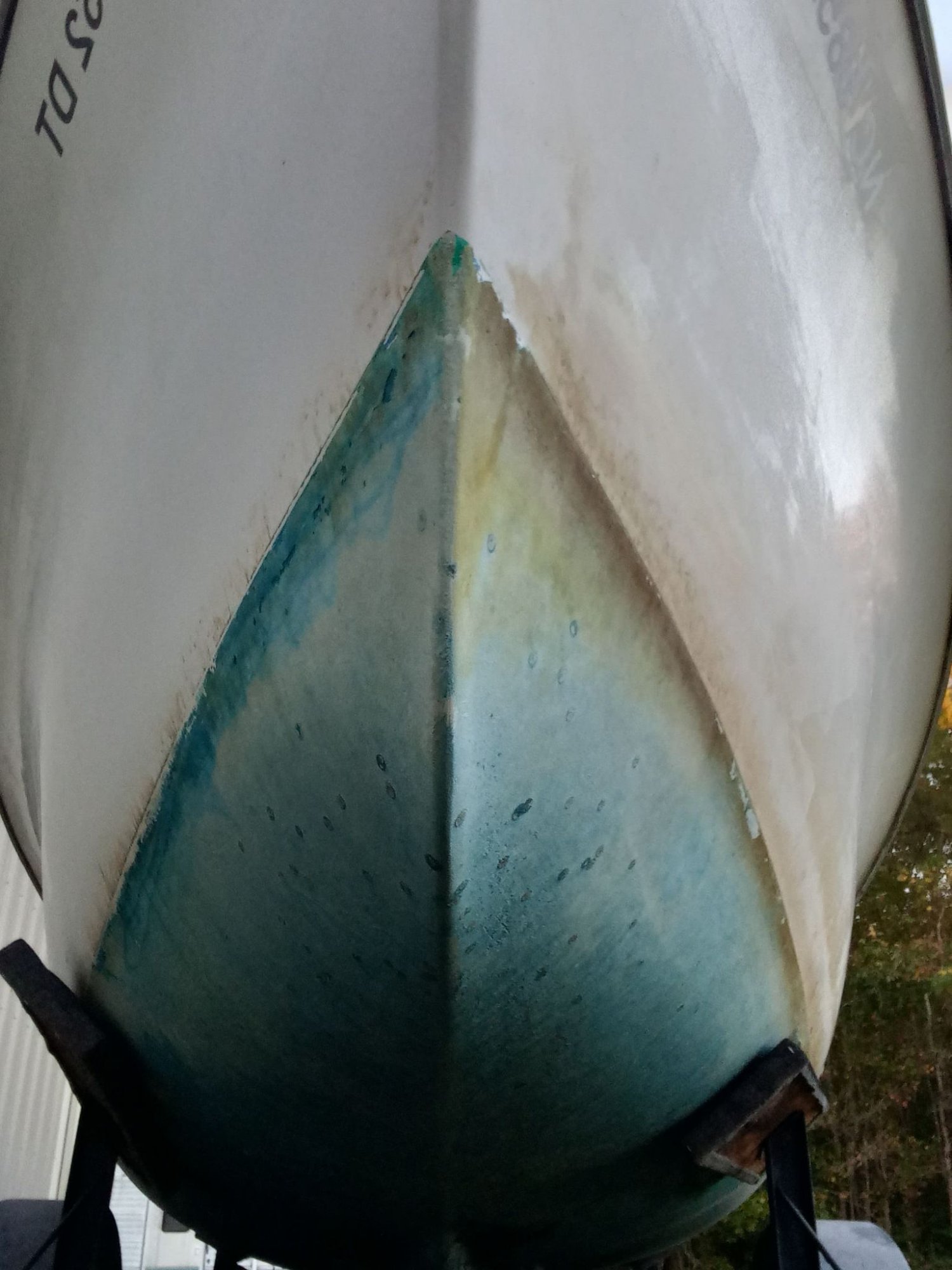

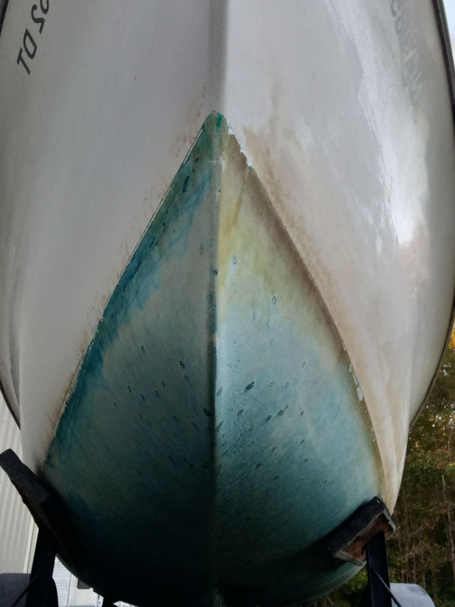

Hello, please have a look...I am considering a 1980 project boat that I have not seen in person yet - only seen a handful of pics that were sent to me.
The bottom has a number of blemishes (not sure of the cause). It has been stored in freshwater on a lake and on a trailer. Does this look like a serious issue or could just be sanded/prepped for a repaint? Thanks!!!

Those blemishes look like osmotic blisters, which can be repaired. Though, it is not inexpensive and it means lots of time on the business end of a sander. Do a search for osmotic blisters and you will find many references. Is it a deal killer? Not necessarily, but it does mean a lot of work and expensive. If you love the boat, are willing to put in the time and effort, and this is reflected in the price, then it may be worth it for you. You could also far ninete, at this age the blisters probably won't get much worse.

The blemishes don't look like they stick out (or in), so it may be something different from osmosis. Perhaps marks from aquatic growth that has been scraped off, or from antifouling chipping off and being repainted? From the photos it is hard to tell how much of a project this boat is. If it checks all your boxes it might be worth a look-see, though as dlochner suggests there are probably other boats like this one that are closer to Annapolis too.

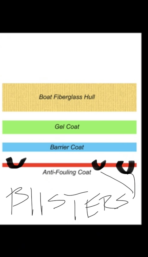

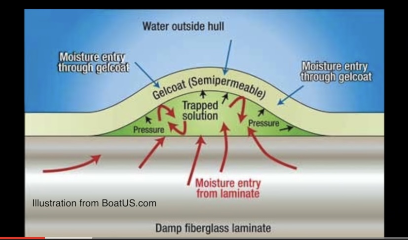

Thank you!!! I wasn’t familiar w/ that term but looking online found lots of material on osmotic
blistering. See attached. In the diagram they show several layers before the Fiberglass hull (Anti Fouling, Barrier, Gel Coat). Im not sure to what level these particular blisters go down to??? I’m guessing the hull has been protected with these protective layers that have the deficiencies
Looking at the front pic of the lower hull there must be 50 and they seem to lessen moving toward the stern.

Without looking at the boat in person, it is hard to say what's going on. Blistering may not be uniform along the hull, there may be areas with little or no blistering and areas with lots of blistering. It could be something else or it could be a poor repair on a blistered hull. if the boat was relatively nearby it would definitely be worth a short drive. On the other hand if you and your wife are looking for an excuse for a weekend get-a-way, this would be a good one.

The owner says that it is where barnacles were scraped off so to me that sounds better than blisters but stiil is work.
If indeed it is just barnacle remains, they are easy to get rid of. Some muriatic acid (hydrochloric acid) or Mary Kate's On-Off (which is mostly hydrochloric acid and a couple other acids) will dissolve and soften the residue. Some brushing and lots of water remove them.

They do indeed look like barnacle scar's consistent size and shape and aren't a problem.
I don't believe you'll find barnacles in fresh water. It could be the owner is using as a generic term for some type of bottom growth so you might ask.
13,066
You are correct. There are other critters, such as Zebra Mussels that do grow and attach to boats however they do not leave the characteristic ring when removed.
More history on the boat is needed. Was it ever in saltwater? Has it been bottom painted while in fresh water? How many owners?
1980 is about when osmotic blistering was discovered. Boats at the time were built with polyester resins which were susceptible to blistering. Eventually vinyl ester resins were used that are less prone to blistering and the problem has mostly gone away.

That wouldn't scare me away from this boat. It is most likely just poorly removed growth - but if it is blisters, it's not a large number and you can easily repair it yourself. A 22' boat just doesn't have that much area to blister. A day's work. And a 40 year old boat is not going to have new blisters appear so you just have to clean these up.
When you do see the boat, look for delamination or structural problems. Tap on the hull with a screwdriver handle looking for "dead thuds" that show things have come apart inside. Look for signs of sloppy repairs. But I doubt you'll find anything that will to serious for your intended coastal use. It would be a different matter if you were planning to circumnavigate.
The Rhodes 22 doesn't have any balsa core so core rot isn't a worry. There really isn't much to worry about with the boat. If you buy it, go over the rig carefully and replace any suspect stays, chainplates or mast tangs. Losing a mast is pretty much the end of a boat like this - too expensive to replace. Here's a great review of the boat that you may already have seen Rhodes 22 - Practical Sailor
If you buy the boat, start with a heavy sanding of the bottom - this will take any old growth off and you'll see if you have blisters. If you will be keeping the boat in the water and are concerned about future blisters, it might be a good idea to remove all the bottom paint and apply several coats of barrier paint before the antifouling. The whole hull could use a good cleaning with On&Off which will remove the stains and other junk. MaineSails guide to waxing will bring it back to "better than new" shine. Great boat worth saving. Tips For A Great Buff & Wax
